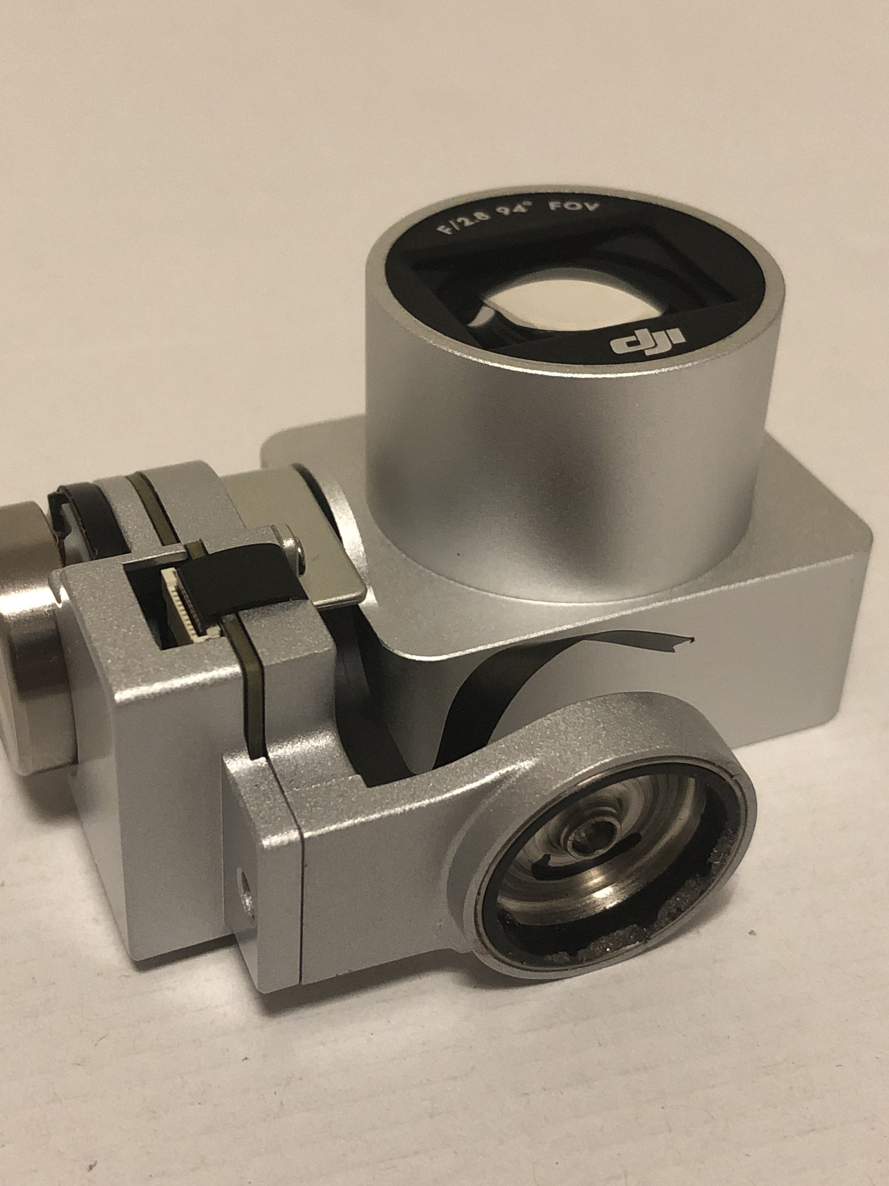

Hi guys,
So second trip out one of the Rotors came off. Should have checked, but you live and learn. Don’t let kids help
Camera has come away, snapping the ribbon cable. Have ordered up a replacement, and will have a go at installing it.

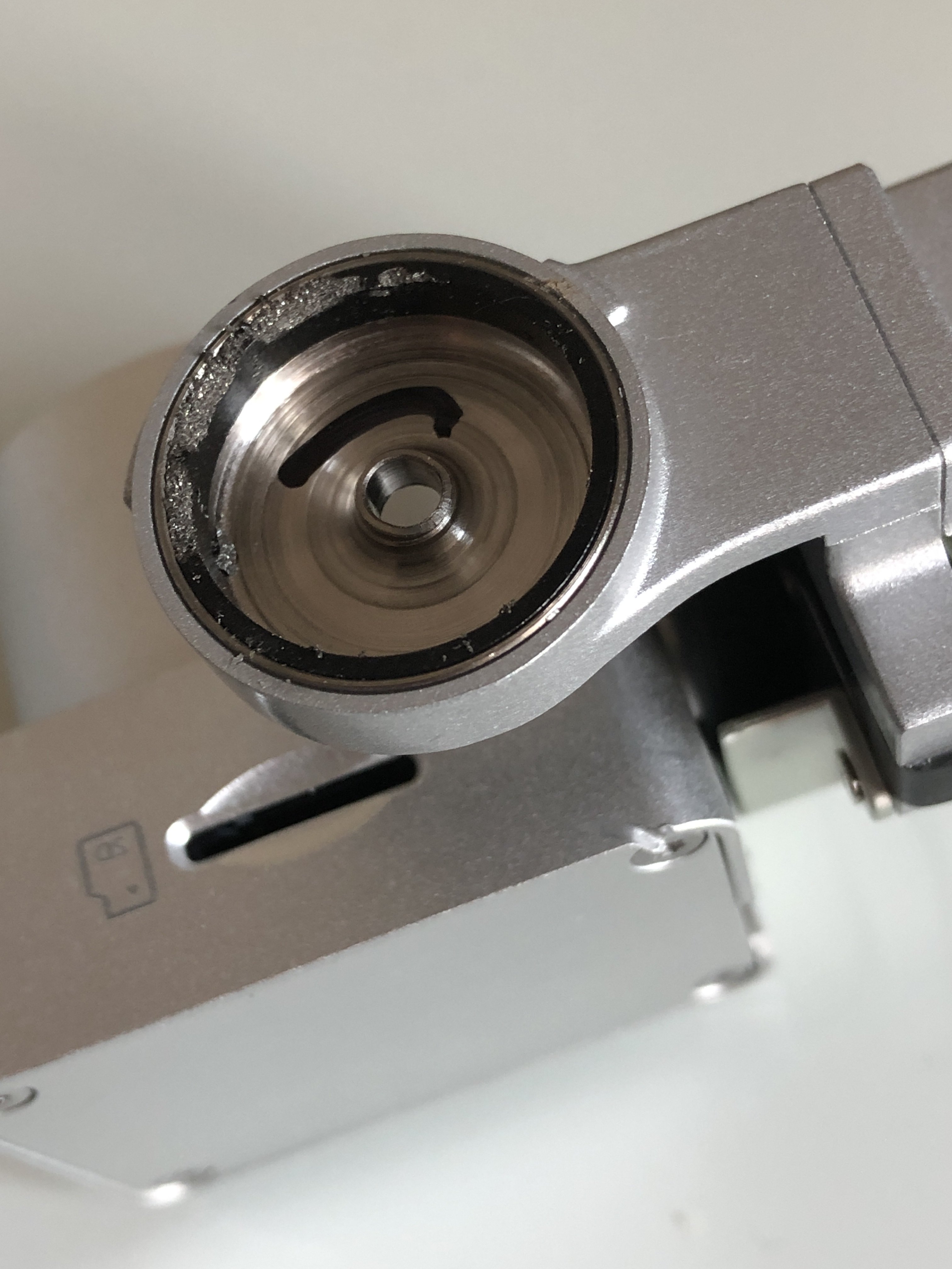

My question is on the motor. This has separated, it goes back together, and I have seen many post about a spot of glue on the outside to hold it. However mine seems to have a scuff where the 2 came in to contact. Should I replace this also?
Thanks in advance for the advice

It is indeed the Roll motor.
The one attached directly to the camera is Pitch (Controls movement up and down)
The motor holding that one on is the Roll (controls movement relative to Horizontal)
The one in the base controller is the Yaw (controls movement from left to right etc.)
The scuffs are on the Roll motor fiber stator. The way it is scarred looks like to me that the roll motor shaft or the bearing housing is bent and will probably not work.
If your going to go to all that trouble with the ribbon cable I would definitely replace the Roll motor assembly.
YouTube is your friend on video tutorials
Good luck with it.
