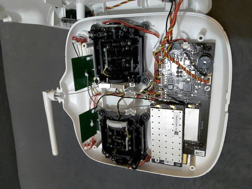

Hughyg, have you tried flying in other locations? For me, the single most limiting factor is interference (from WiFi?) in urban settings. Try flying in an open field away from homes. If you get the same results, you may have a coax cable inside your controller that wasn't seated correctly at the factory. A DIY fix if you're up for it.
Mike which coax cable is that. Is it the one that's seen in the photo? I was able to fly over 1000 meters but after firmware update I can only go up to 200 meters in an open area. If it is the cable on the photo it seems it is fitted ok. Do I need to remove the glue to check?

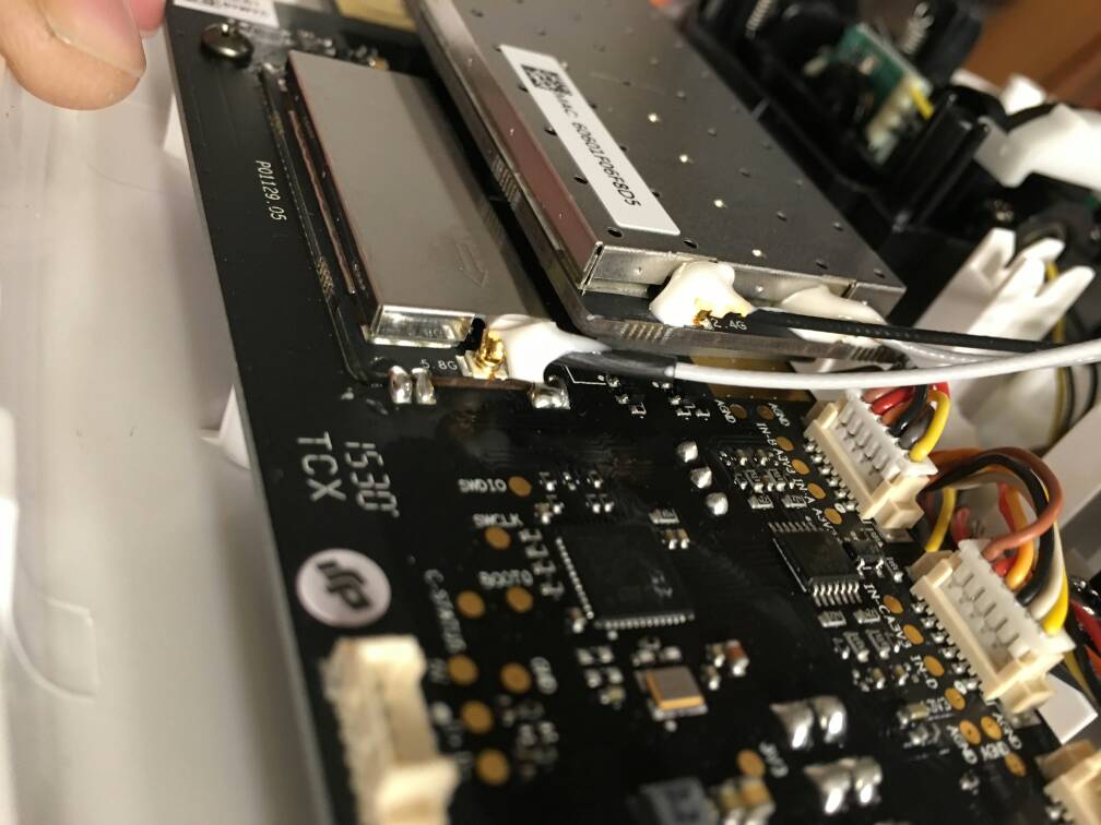

Is it me or does that u.fl connector look like its on at an angle not fully seated flat?
Did you lose video or control first??
The single cable seen at the lower left in the photo is your 5.8GHz controller coax and fitting that runs to the external antenna on the front center your controller. The ufl fitting is not seated correctly. Carefully remove the white 'glue' and remove the cable from the board. Inspect the fittings and make sure the 'wings' on the coax side weren't bent inward from the last attempt. Then, carefully place the coax ufl fitting directly on top of the board side and push straight down, firmly. You should feel the coax side seat onto the board. check the connection by being able to easily turn the coax parallel or horizontal to the board without lifting up. It should stay attached. Be careful not to lift or twist on the connection as it will put stress on the board.
The other two coax cables are the 2.4GHz cables that lead to the internal pucks inside the controller.
Good luck. I used liquid electrical tape, GB brand found at Home Depot, to re-glue the coax down. Let it dry good undisturbed over night.

I doubt this is a mechanical issue if you were flying to 1000m prior to the update. Have you tried to re-bind the AC to your controller?
Ohhh ok I thought that I've seen that before lol
Reactions: dirkclod
After reading the other posts, I see this is not your unit. My error for not looking first.
Yes i have rebind the RC but no success. There should be something else. I will check the cable connections again according to @Mike's Bird instructions. Hope there will be a solution.
That is 100% not fully on

Here is a photo from my RC. I think everything is in good condition

Can you take a very close pic of it. Its hard to see it and its hard to see at that angle
