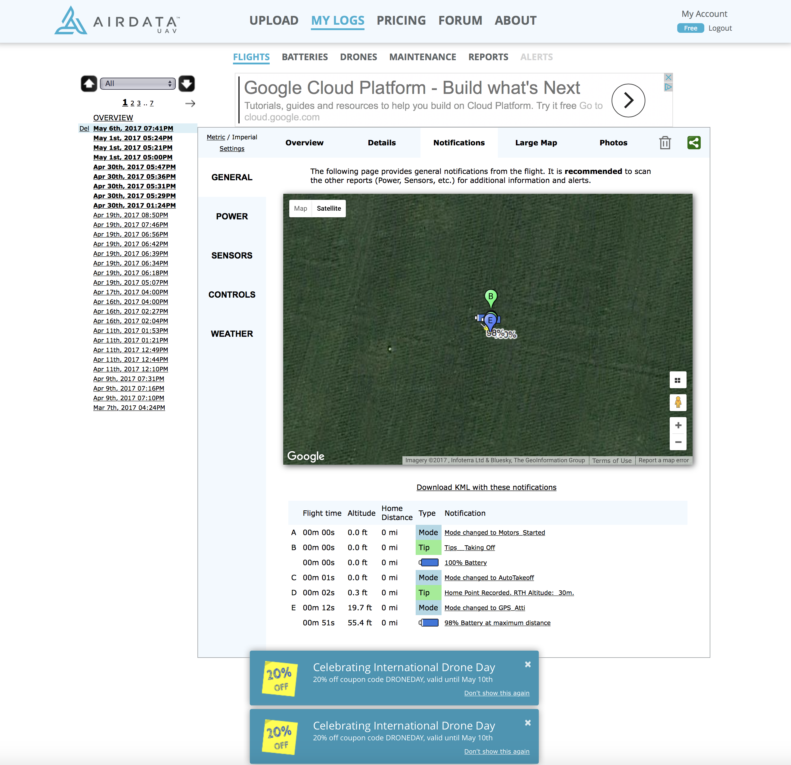

After recording my RTH point I took off yesterday evening and ascended. After 50 seconds of going straight up I reached 60 feet or so then the rotors turned off and it plummeted to the ground smashing the gimble completely off, ruining the landing gear and damaging the shell. I have a magic pro and p3 and have been flying for 2 years and never had this before. Looking at flight log it says ATTI mode kicked in but that shouldn't disengage rotors should it. I don't have DJI care as I never used it on my p3 so I'm stuck with a ruined p4pro which is going to cost a fortune to fix !

Please upload your TXT flight log here and post a link back here so we can see your flight data.
It would also be helpful to see your DAT flight log. You can find instructions for location your DAT flight log here. Upload it to a site like Dropbox.com and post a link back here.

Your P4Pro had an abrupt power loss. The method used to see this is to look at the motorVolt data which is 50 Hz. (The battery data is only 1 Hz and has a 1.5 second delay). At the end of the .DAT motorVolts were around 16 volts and then dropped to around 7 volts when the .DAT ends.
This incident is very similar to several Mavic incidents. Maybe there is a common manufacturing problem. IMHO you have a good warranty claim.

Sounds to me like a faulty battery . . possibly an internal wiring fault and you lost half the cells all at once(hence the 7.6v on all motors all at once). If it was a loose battery connection it would have gone to zero. Have not seen the data file but I can't think of anything internal to the machine that could cause that simultaneous behaviour on all four motors. Software maybe . . but rather unlikely. Did you get any further analysis back.
Reactions: BudWalker
That's interesting. Looking a little closer at the very end.
There are 2 samples between 16 volts and 7.6 volts.
The minimum voltage required for records to be written to the .DAT must be lower than the normal operating voltage. I had always assumed that the volts drops to 0 but there is some capacitance in the system. That's why a few records can still be written after the volts drop.
There are a few Mavic incidents where it was clear the battery became loose. (These occurred long before the recent spate of power outage incidents). Those incidents exhibited the (relatively) gradual motorVolts decline at the end.
My pet theory is that there is some safety circuitry in the battery that's supposed to prevent an explosive discharge. It's better to shutdown the battery than having a battery explosion. Just spit balling here; I don't know much about lipo batteries
