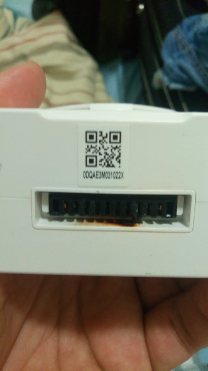

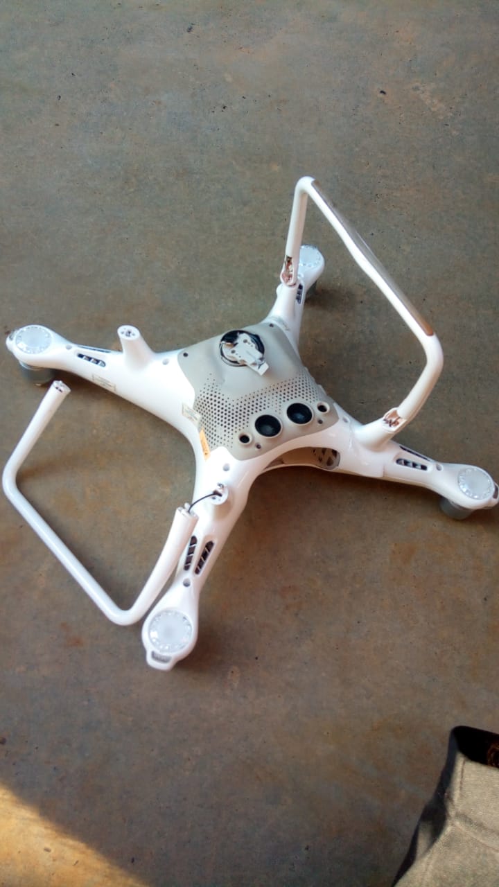

Hello, I had a problem with the voltage of the battery of my Phantom 4 Adv and I ended up falling at the moment of landing to 130 meters of height. At the time of the electrical stop, the system stopped recording the flight record of my DJI 4 GO. My Phantom was for analysis in the DJI Defects Department and they claim that nothing wrong happened and that it is a road accident. They analyzed the flight record and found nothing ... Well, they did not find anything because the system itself stopped recording and of course nothing would appear in flight logs. I'm outraged at DJI's position on my Phantom ... Has anyone ever had a similar situation?
When was this photo taken. Before or after you sent to DJI? The flight logs on the app will definitely stop, but there is another on board file as well. Looking at the electrical burn in's it may have stopped as well. Yet another case of a P4 dropping from the sky for no apparent reason, but this is something new and different......Hmmmmm.......
Yes how could they not see that,unsure if that relate to batt clip failure but it has moved in flight somehow causing it short out I'm thinking,,,I would send picture to dji again ,that's not pilot error,,Hassel them nicely and don't stop,,sad to see p4 like this,,,

What is that burnt contact on the battery? Was it there before the fall?

Fly Dawg, this picture was taken before sending it to DJI. According to my salesperson this is not something new, sometimes it can happen. Thank you.

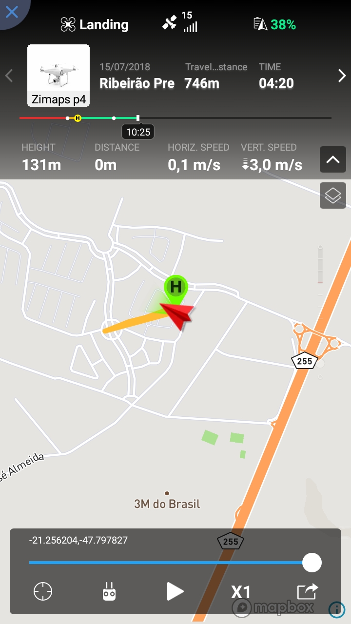

Look, this was the exact moment of the fall when the record stopped and P4 crashed.
That tells me nothing. If possible and you still have the flight log on your tablet or phone. Upload that to the link below. It most likely will not tell us much, but possibly. The aircraft file would be better but it is something to go by. Place a link back here to the upload if you do.
Log Viewer

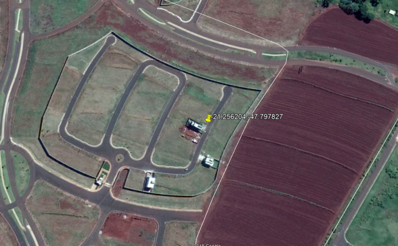

This shows the location as here, correct? If you upload the data file, it is possible, though I grant you remotely so, to locate a probable cause. If you thoroughly reviewed the data, it is also possible that you missed something. The only way to completely review this is by .csv line by line.
