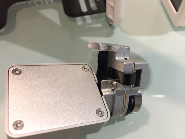

    Garry, there are many threads on gimbal repair topics. I had broken my gimbal arm too once and it is repairable without having to replace the whole gimbal and camera. Only the arm can be fixed especially if the ribbon is not broken. Seek advice from your dealer. The repair cost should be than 200$. See attached the picture of my gimbal when it was broken. Good luck and cheer up. Your bird will soon be back in the sky, but next time, take your time in knowing your new favorite toy

    if only arm broken and cables are ok, I would glue it

    But my camera isn't broadcasting a live feed now. So I wonder if the gimbal gyro error is stopping the camera from initializing or if the camera is actually conked out.
    I read in forums of camera surviving. A 5 story drop onto pavement. My drone dropped down from about waist height onto damp grass patch.

    Hi guys, i crashed my P3P yesterday, broke the gimbal and lost the ability to film or shoot. However, i've fixed it already.
    I was at my local dealer earlier on to ask them to send my drone to DJI for repairs when i saw that the 4K camera gimbal component has arrived at their shop.
    So i made the decision to purchase the new gimbal camera to replace my broken unit.
    Right now, i'm sending my broken gimbal(with camera) to DJI instead. If they have that little support strut in the gimbal in their spares drawer the repairs won't cost a bomb and i'll be able to sell the repaired gimbal+camera to whoever wants it to keep as a spare.
    Though i splashed alot of cash within these 3 days, I am really happy i've got my bird back and things have returned to 'normal'
