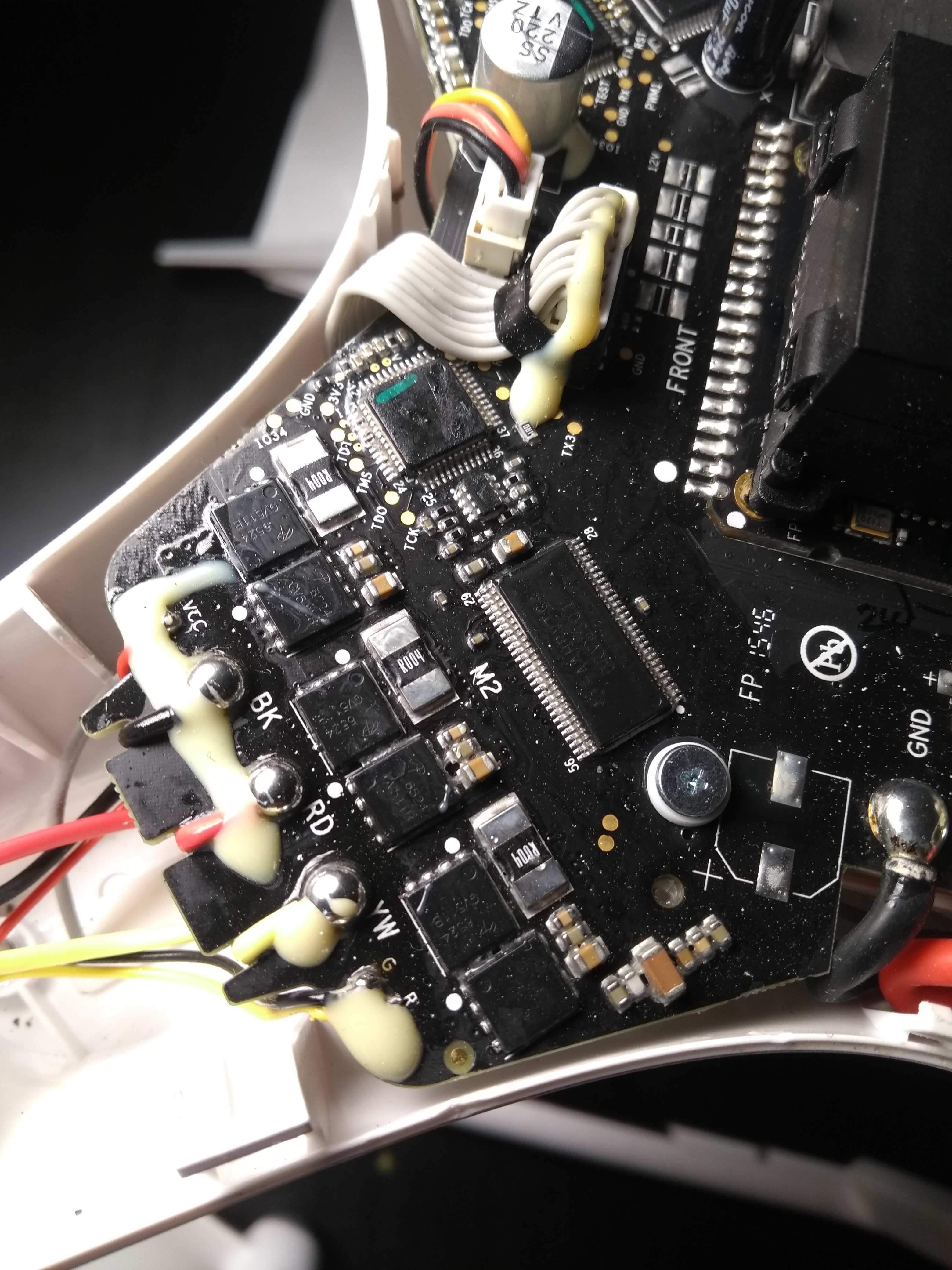

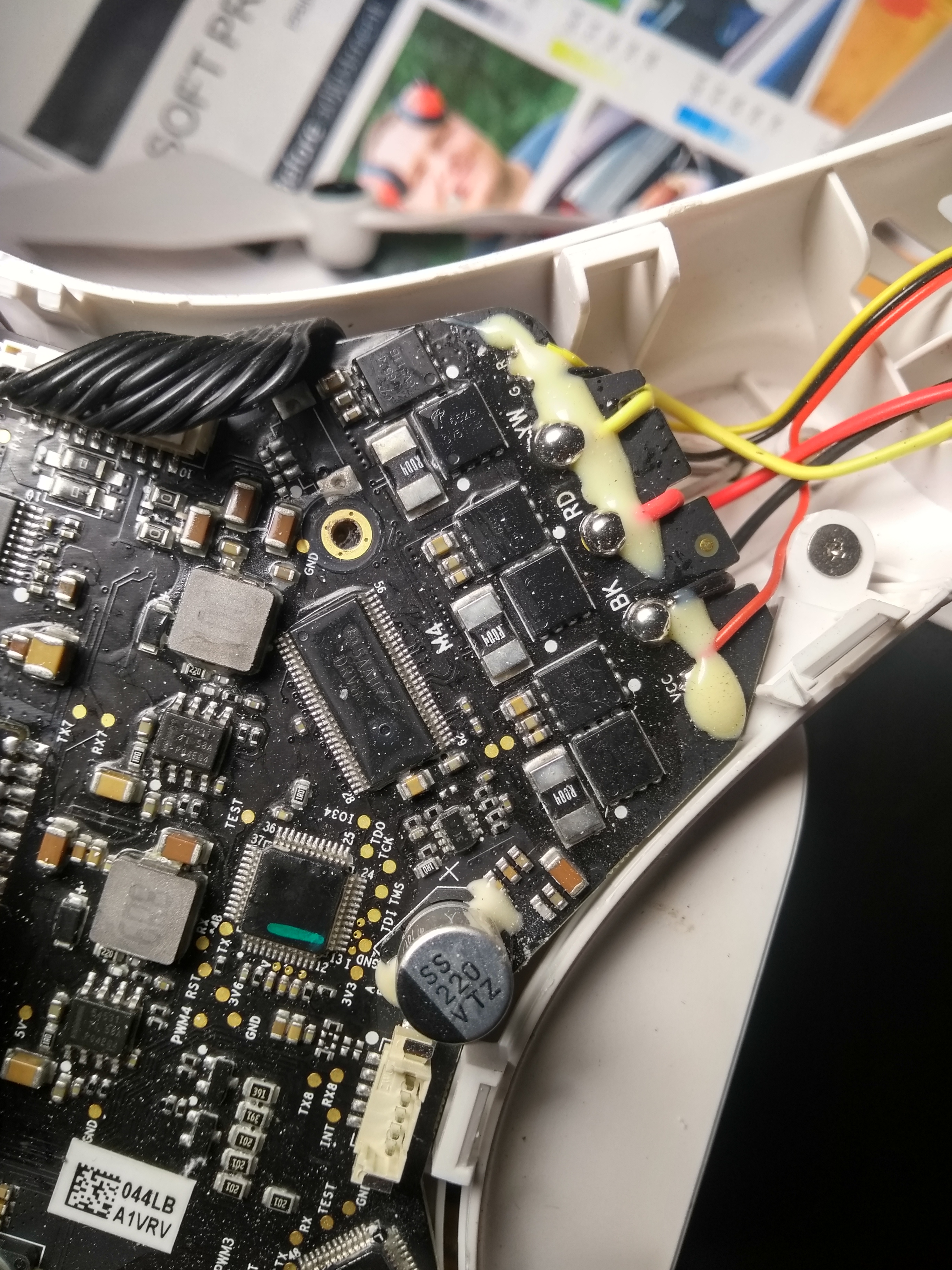

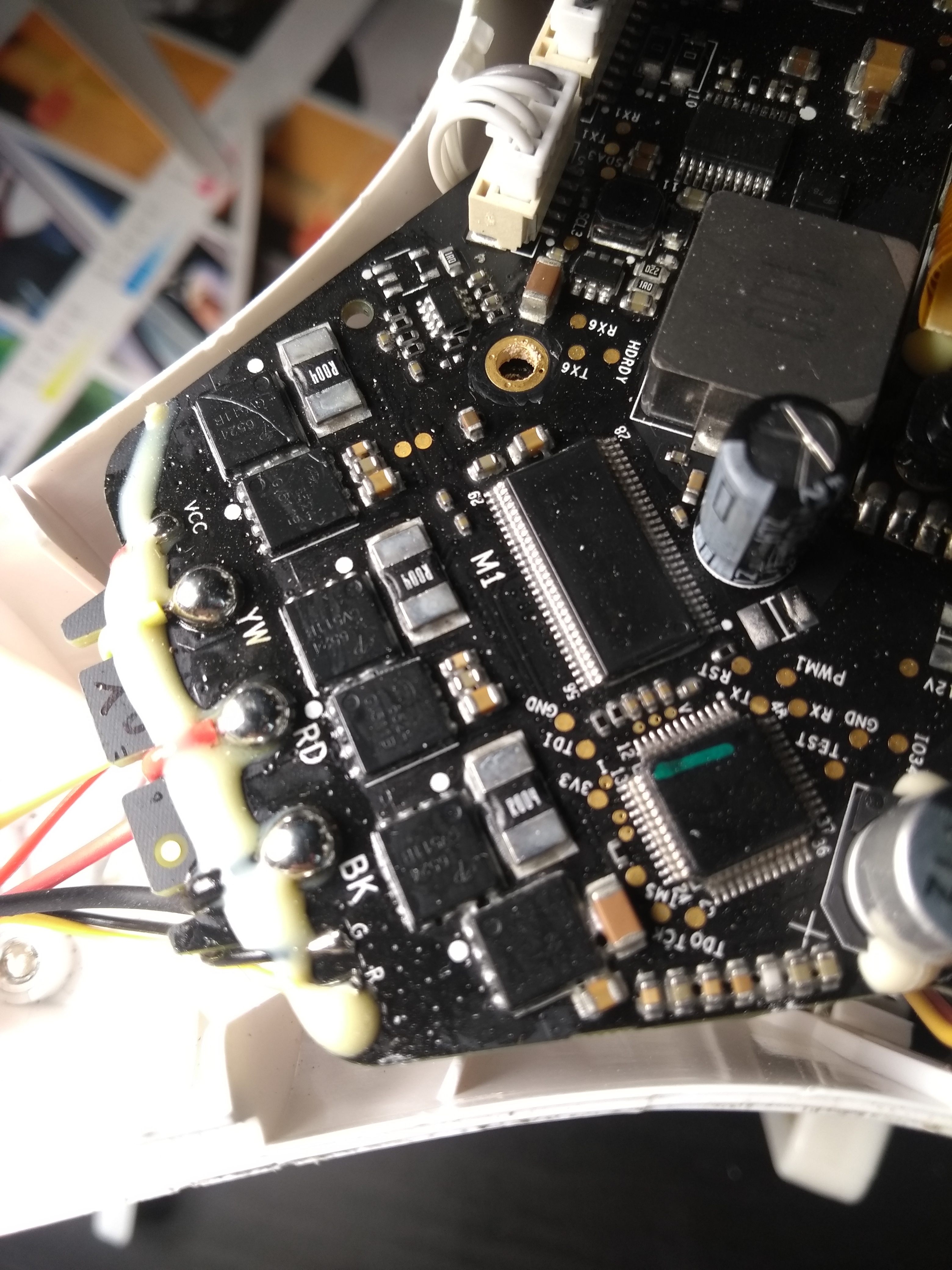

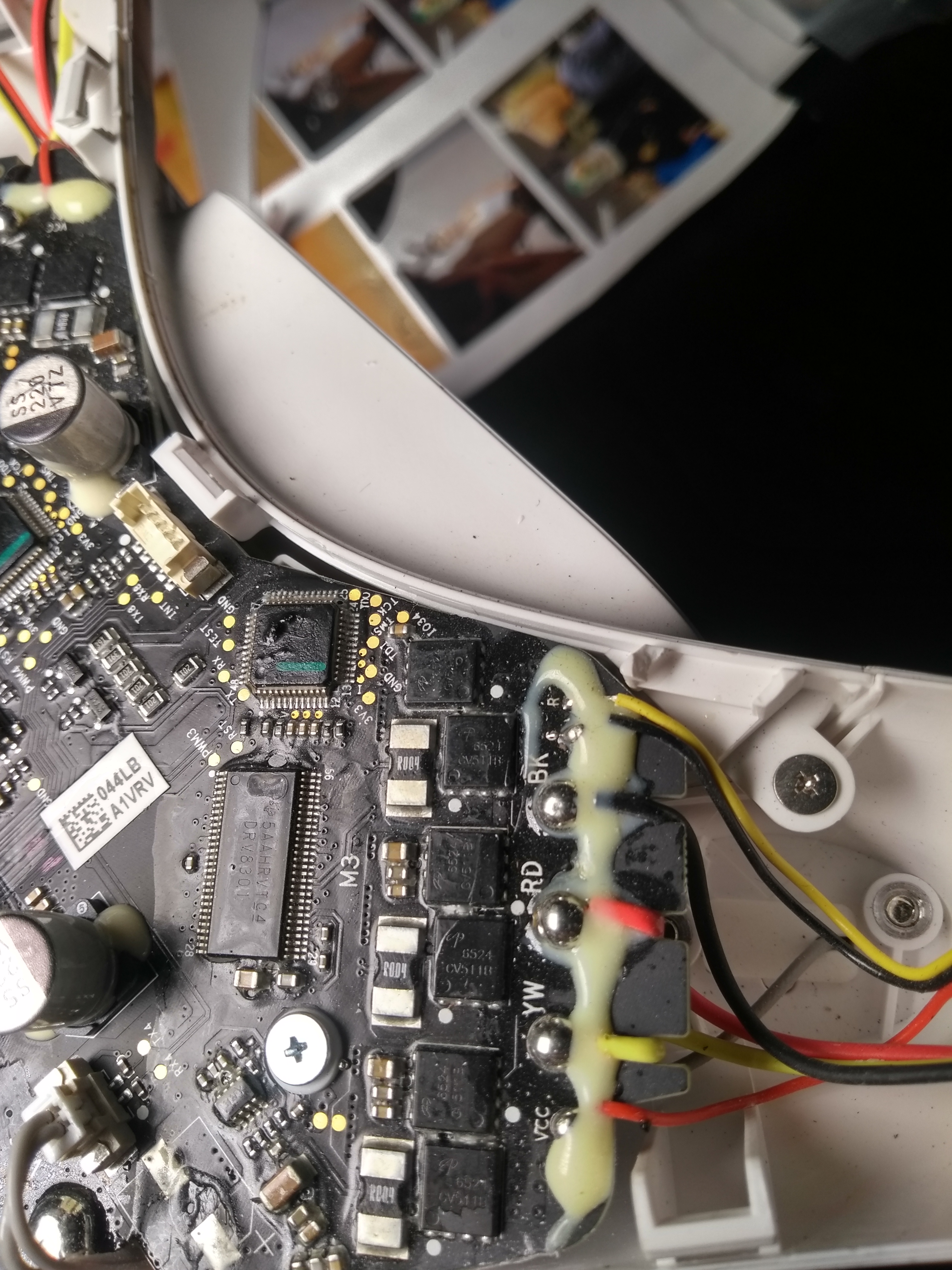

First of all, I would like to apologise for my absence. After analysing all posts the best solution will be to unsoldered all 4 motors and 'ohm' the coils of the motors as
N017RW suggested. Moreover, I've looked 'under the phantom hood' to check visually if I have any damage to the motherboard. Gladly, nothing unnormal has been founded. Also, I've stated it up, and I didn't find any error connected with the motherboard, only overloaded gimbal motor due to a flex wire which also I 've had to change. All camera function works (tilting on sides, record and button, vision etc). I assume that camera motherboard it's fine, but I am not able to 'force' brushless engines to start by using a dc controller. Another solution, which I am considering, is to buy another drone without a camera, which has good engines and motherboard, so then I will be available to just swamp my 4k camera from the old drone.
What do you think about it guys? Is it a good idea?

I doubt all 4 motors failed at once - if any. The ESC driver chips would fail before any of the motor windings burned up. Your ESC driver chips on your photos look decent. Often an IC failure will cause a burned spot or bulge on the top of the plastic housing. On your 3rd photo, the IC in the center left (right of the paper label) does not look good. Is that a burned bulge on the IC? That would not be a good sign. That may be the motor controller IC that controls the ESC chips that failed. Also, since your drone landed in the dirt upside down, clean the motors out well with compressed air and/or alcohol. It takes a surprisingly small amount of dirt or a couple grains of sand to seize the motors. Good luck returning it to service and stay away from those trees. They've claimed more drones than we can count.
