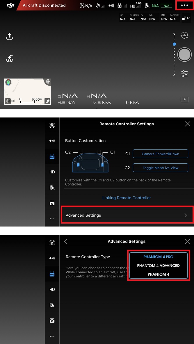

The GL300E is compatible with the Phantom 4.
Before attempting to link the GL300E to the Phantom 4, you need to set the "Remote Controller Type" setting to "PHANTOM 4". You can find that setting in the following section of DJI GO:

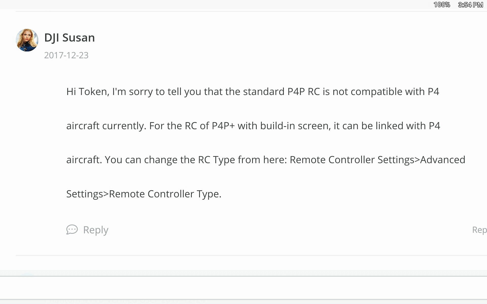

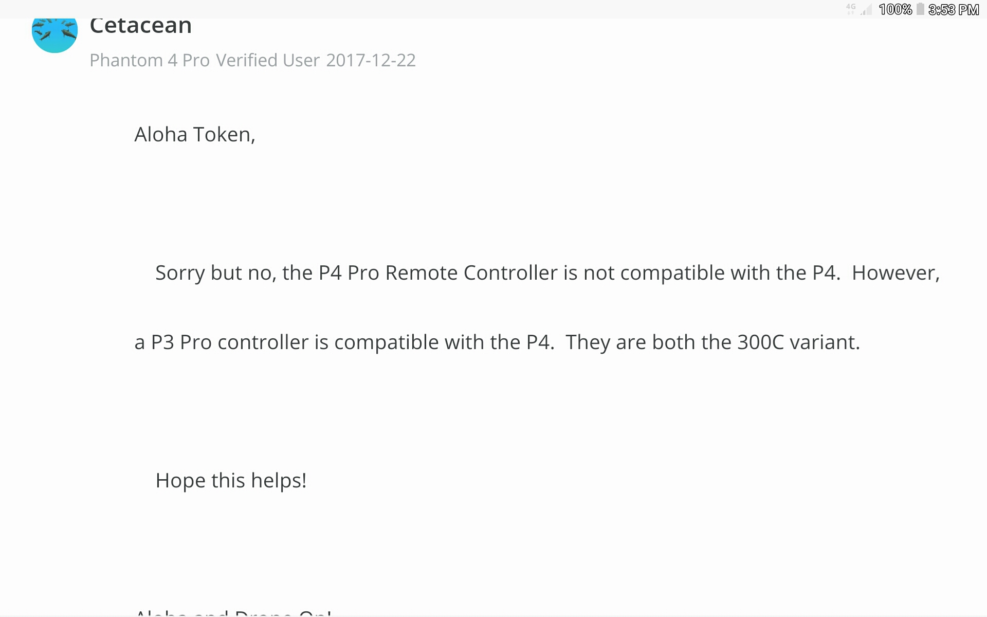

[QUOTE="JOHN1234567, post: 1423080, member: there's a few compatible remotes,p3pro for example is gl300 same as p4 remote,,,I just read p4p+ not compatible and hope that's right
OK me posted wrongr info,,very sorry ,,dji Susan confirm it does work
