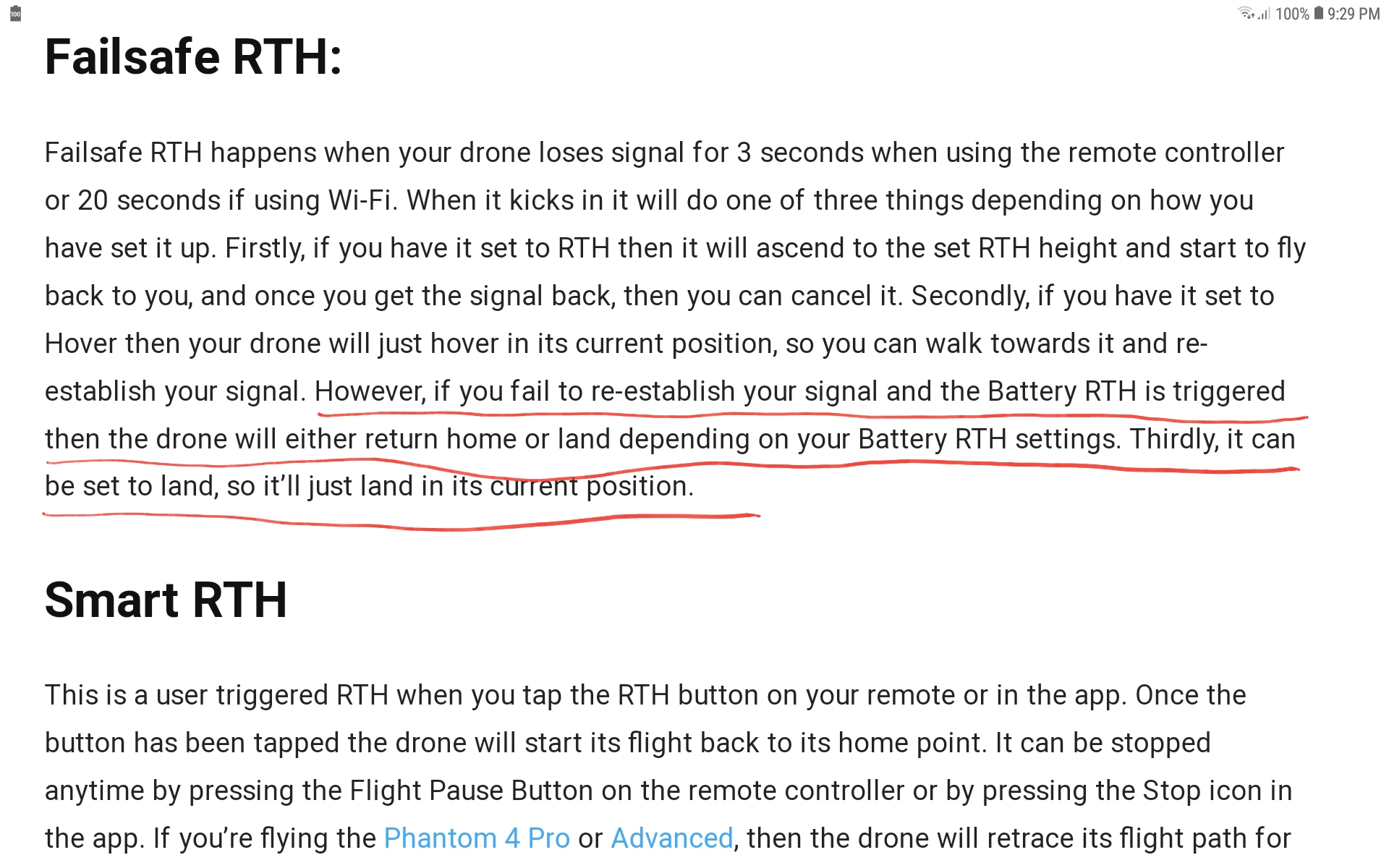

Ok think I gave you SRTH stop
This from manual ........dont you get a X onscreen you can press to cancel ..........2 is telling us it could be your settings,RTH,,HOVER,,OR LAND WHERE IT IS ,,check all these and see if ok,,yes in past if signal lost it used to regain control by the remote so not know what has changed,,relink it mayby,,
