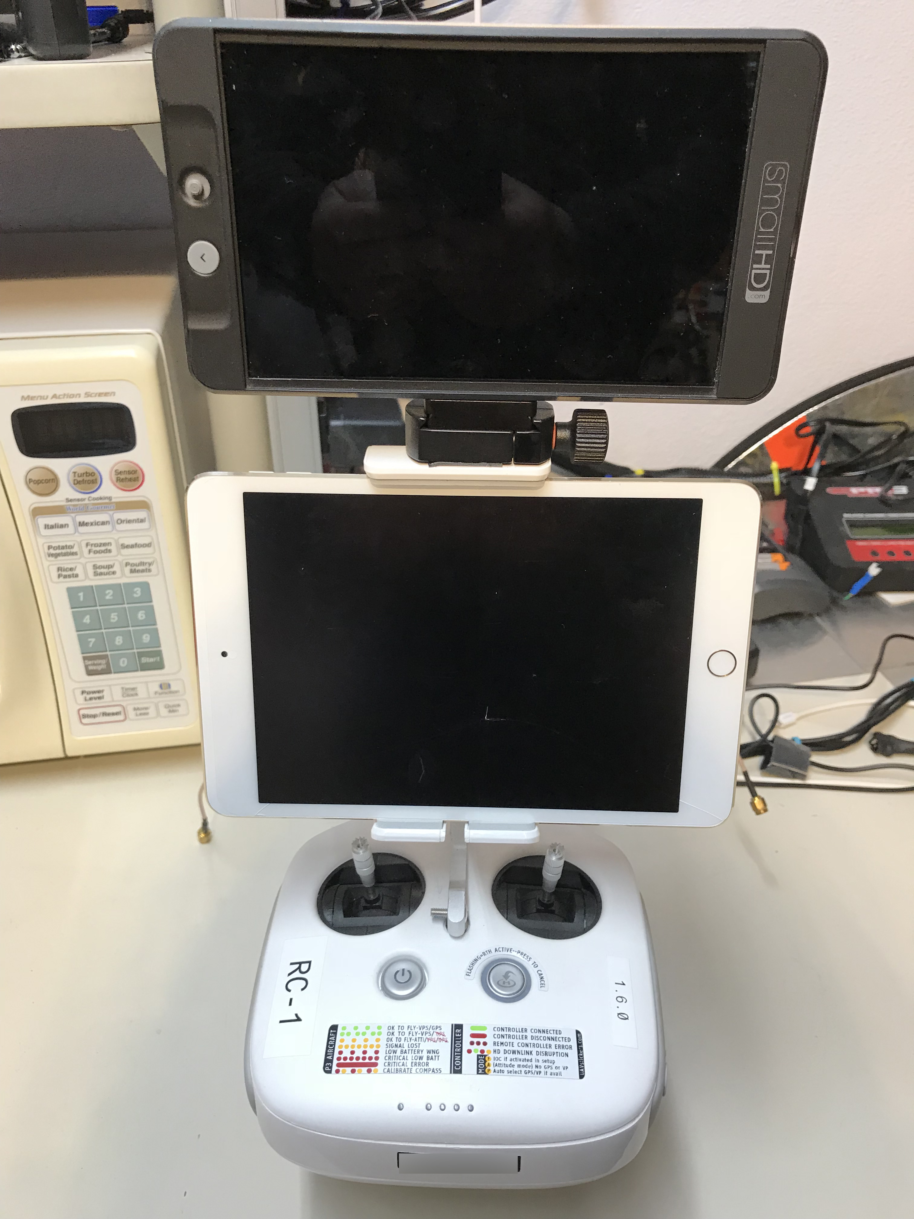

You have your tablet / phone for control and the monitor as, well, a monitor. IMG_9410.JPG
Not perfect - more weight and complexity and you need HDMI out. But - no having to deal with DJI's inability to push out decent software to the Crystal Sky monitor series.
I had high hopes for CS to replace this set up, but alas, at least for the moment, I'm back to this method. The newer SmallHD monitors are up to 3000 nit which ought to be bright enough for anybody....

Hmm looks a little bit much I’m looking as well as others are interested in a simple yet reliable solution instead of trying to hack things together but whatever works for you , as of recent things have been working great ,I’m a city dweller and I enjoy flying distances without any worries , here’s one from this morning

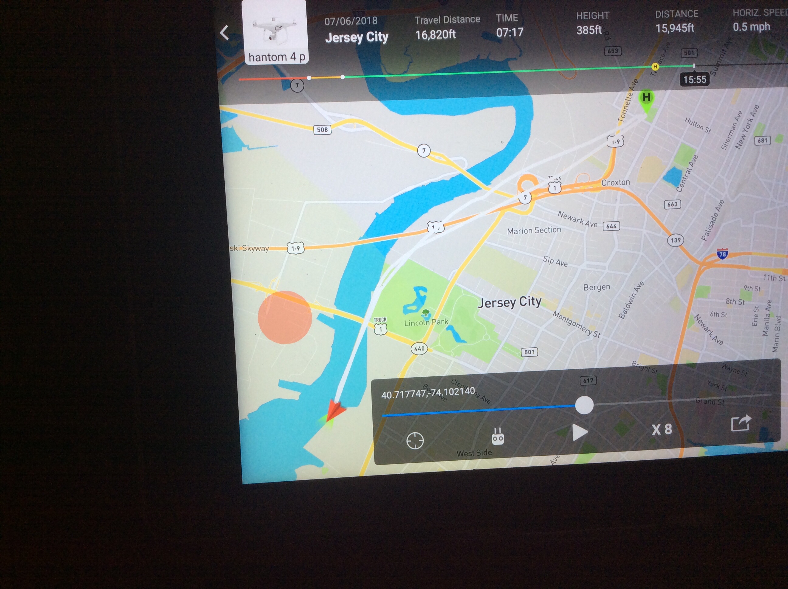

OK I went for two flights using the same flight path and altitude and 5.8 Auto started giving me the "Weak transmission warning" and choppy video at 6-7k ft I get flying till 10k ft when it just became terrible and unsafe so I turned around but when using the Custom channel I passed that distance by 5k ft before I received my first warning...
Today it was a little hazy compared too the last two days which to me also slightly decreases the distances I'm able to fly.. Have you noticed this too
