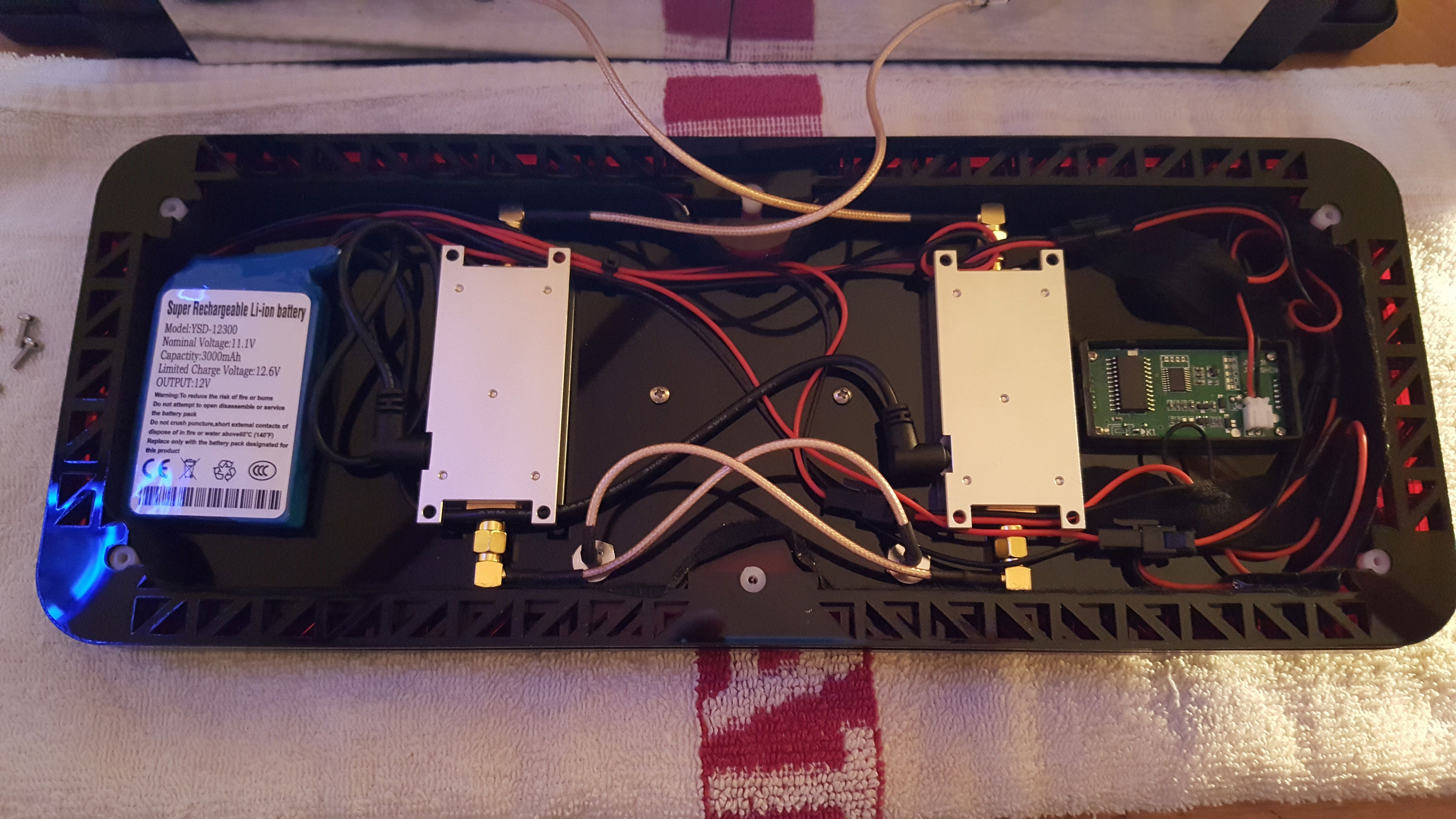

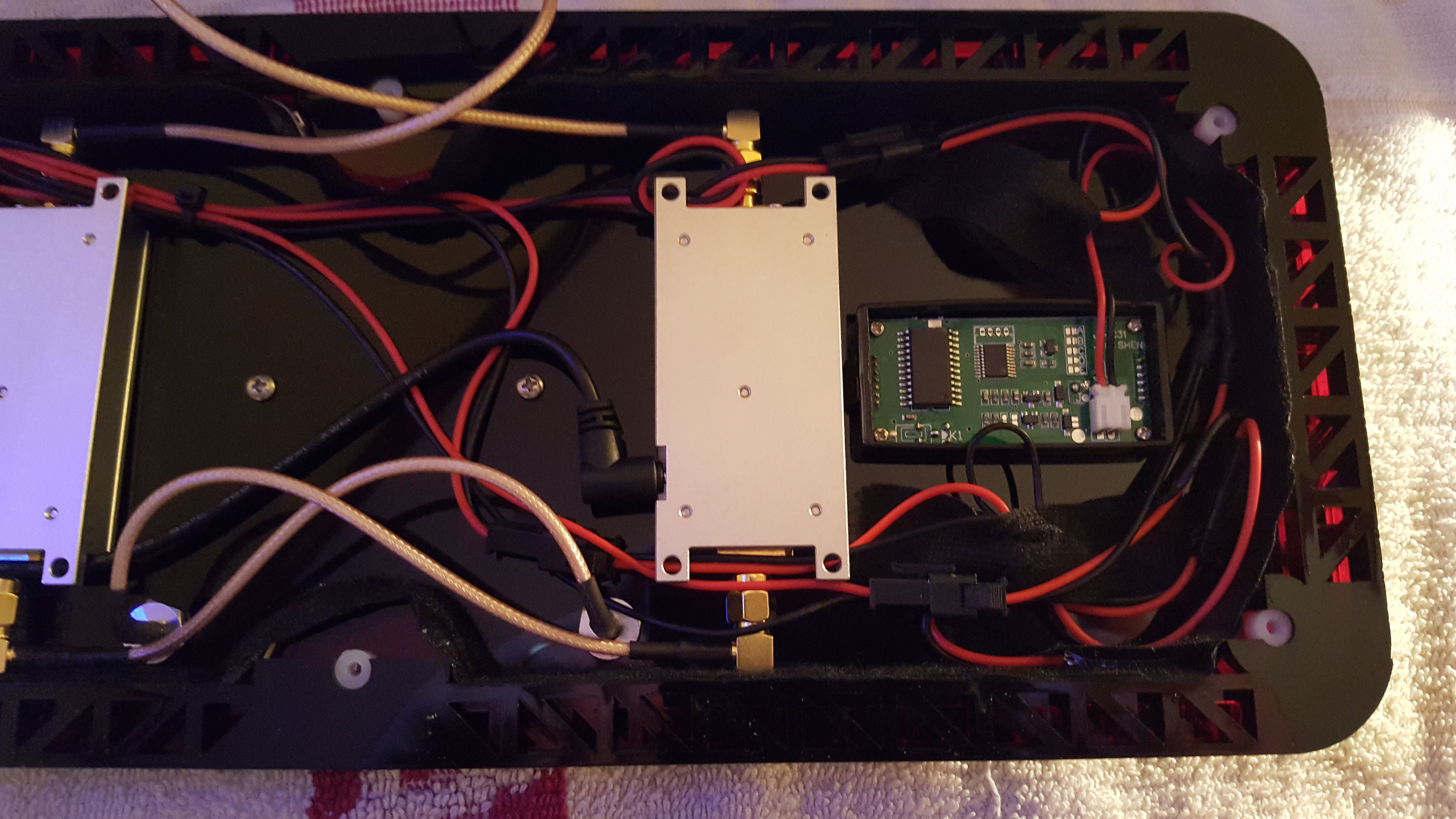

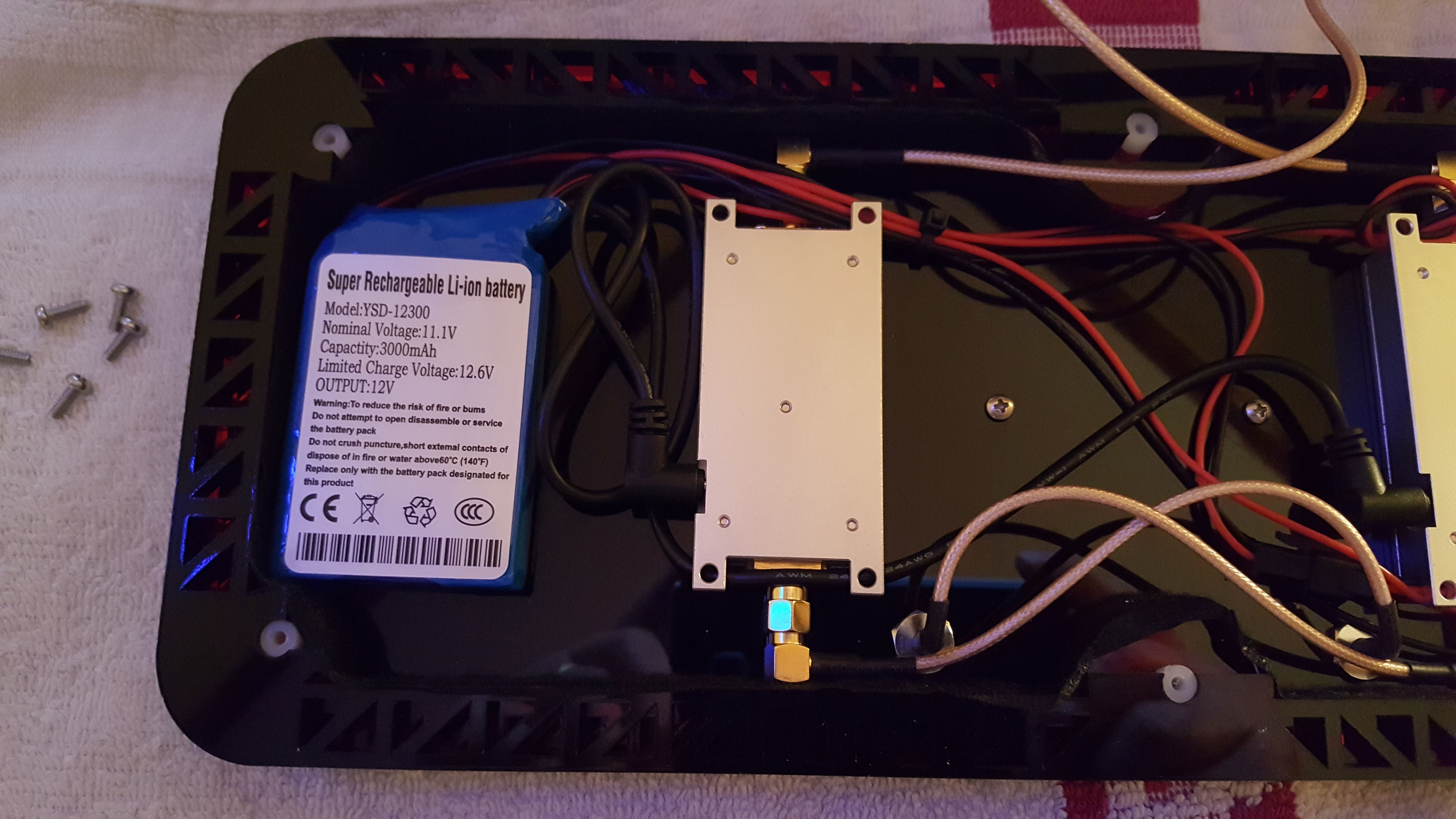

If there's anyone that questions the build quality on the inside I think these pics will surely show that they do know how to put together a **** nice antenna system.

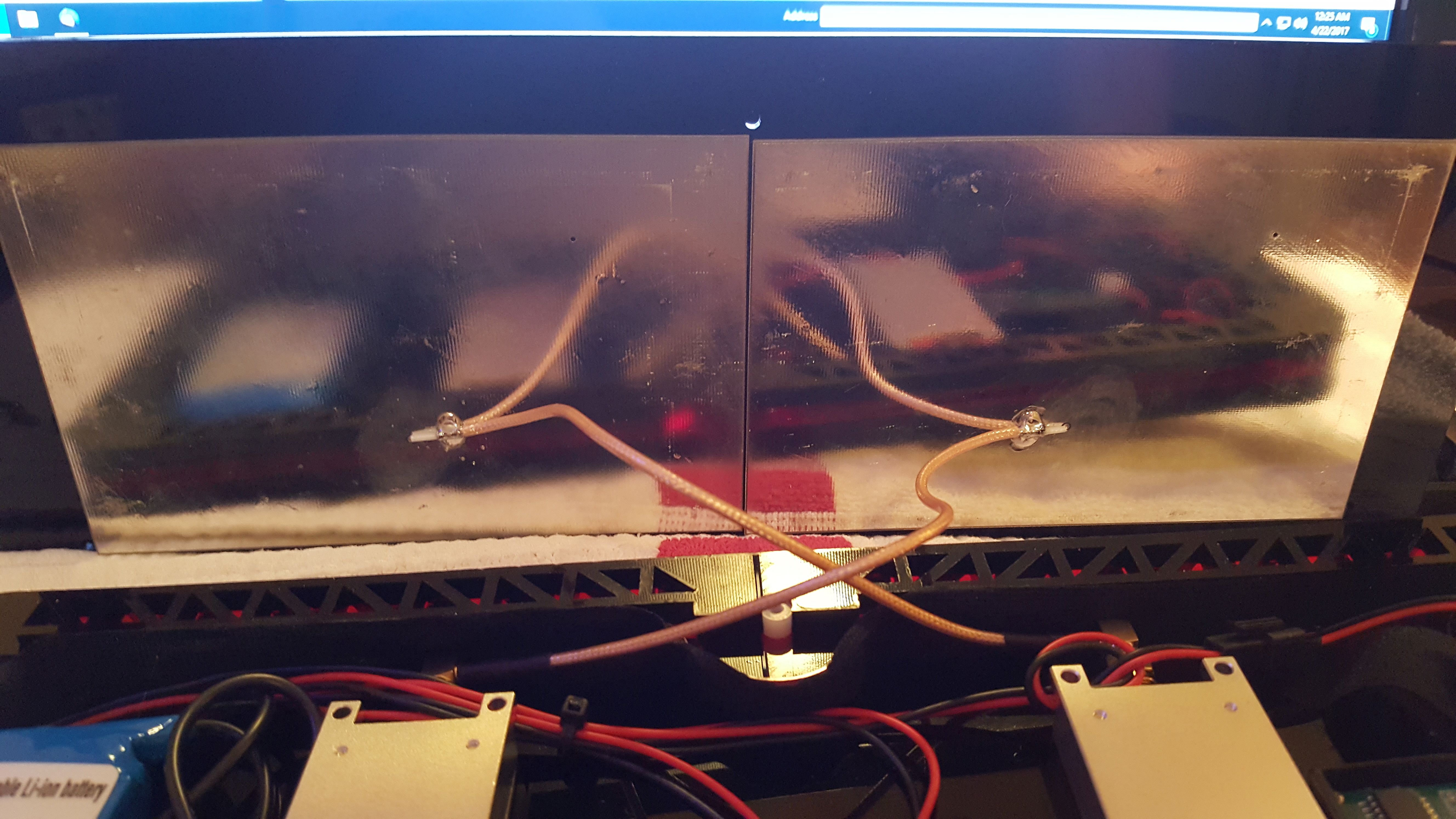

Oh that's ok not a big deal breaker for me anyway. Yeah I just couldn't help it I just had to see what was inside this thing. As you can see by the pics they have done a very nice job with it. In no way does it look cheap inside. I was asking them about the center frequency of the flat panels and here's what he had to say.
You Have a New Message
Titan Drones, Inc. replied to your message:
Hi Donald, They are tuned to 2.4 ghz and actually achieve 19 dbi at 2.4. At 2.44 they are at 14 dbi. They operate from 2.34 to 2.482 with 2.4 in the center.

Lol curiosity killed the cat! I'm glad you did and you posted pics too so thanks for sharing with us who wouldn't think to attempt, is the battery easy to remove and replace? As someone was saying something about it having a recommended life span of 3000 chargers which I think is a ton but wonder if the battery would be an easy replacement if you had used it to that extent
Definitely easily replaceable, once the panel is open. It's a standard amp battery. Hopefully, he can put Humpty Dumpty back together again, with the same ease! :cool:
The two separate antenna panels inside are more reminiscent of the largest MaxxRange antenna setup with giant two external separate panels. I thought I remembered the name Titan being associated with it??
