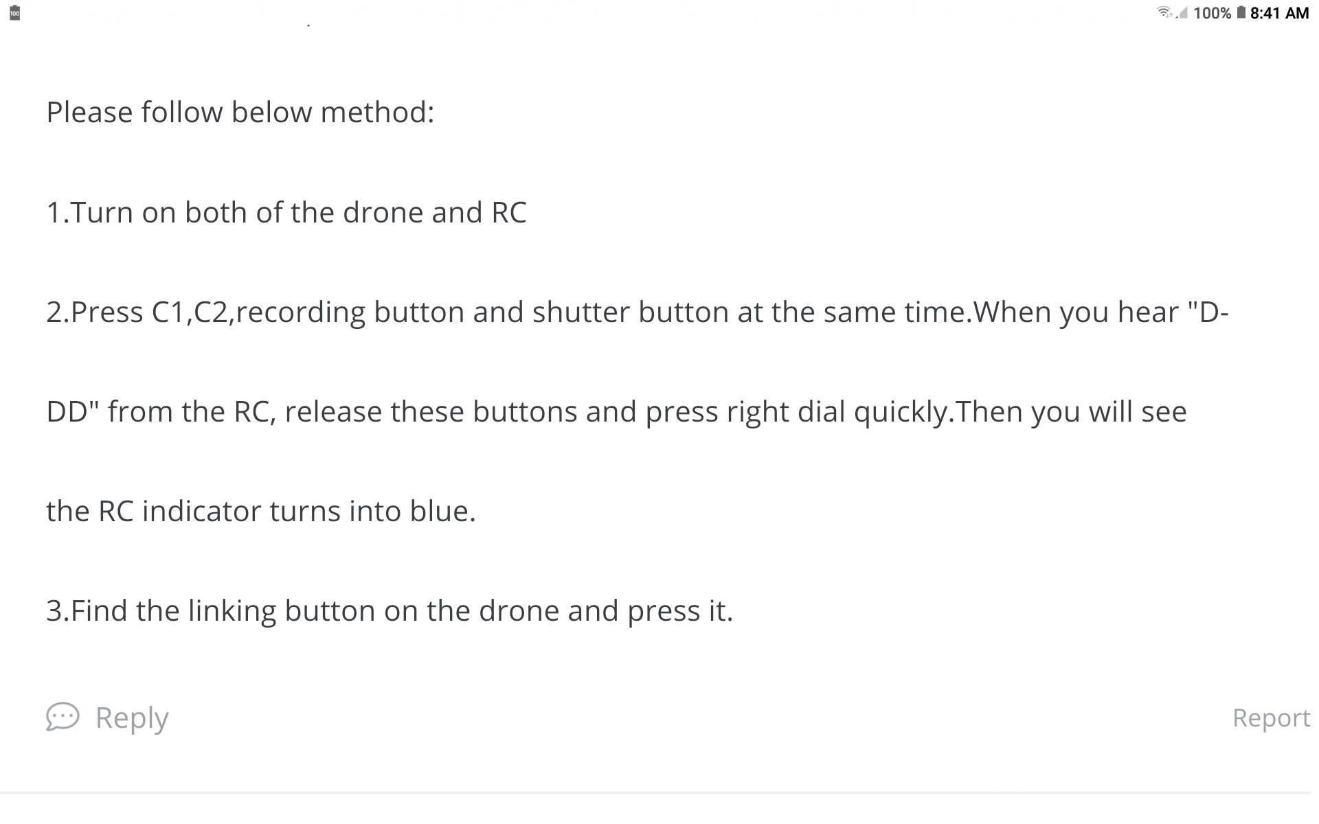

My drone won’t connect to my RC, when i press link RC in dji go app settings, i pressed OK and nothing happens? Any solutions?
Try this method,,if not work with drone on,do same method with drone off and do same method and turn drone on and press link button
