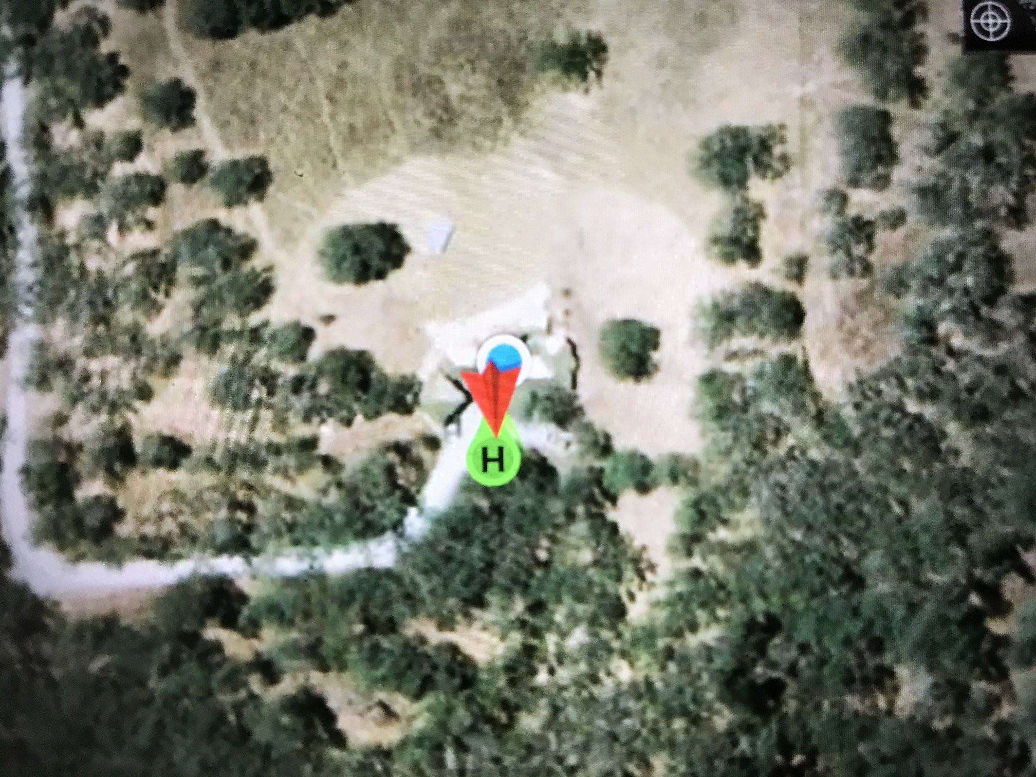

@bkushner the single most effective check you can do to prevent a launch time fly away is determine if the heading shown in the Go App is correct. Before launch look at the red triangle on the map display and then visually check to see that is consistent with the actual AC heading.
If it's not right then don't launch.
This is a much better test than checking the compass MOD value. In most launch time fly away incidents the MOD value is only slightly different, if at all.
