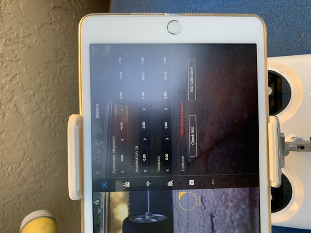

Thank you both. I have been flying from my driveway in a small residential area. I have not had any issues in previous flights but had a hard landing recently. I will check the compass status in the app. Didn't realize the app had this much info available.
Looks like I have a bad compass. Not sure how a crash could cause this since it’s covered.
The problem is probably a break in one of the very fine wires right at the sensor which is down in one leg.
Otherwise the connection to the mainboard is loose. (That's quick and simple to check on a P3).
If it's broken, replacing the landing gear - just the compass side, should fix it.

did u check if the connection to the main board was loose or discinnected?
Yes. I've checked the connection. Disconnected and reconnected a few times. Checked compass in the landing gear and I had 2 of the 3 wires come off the board. Didn't even look like they were soldered very well. New landing with compass came in today.
