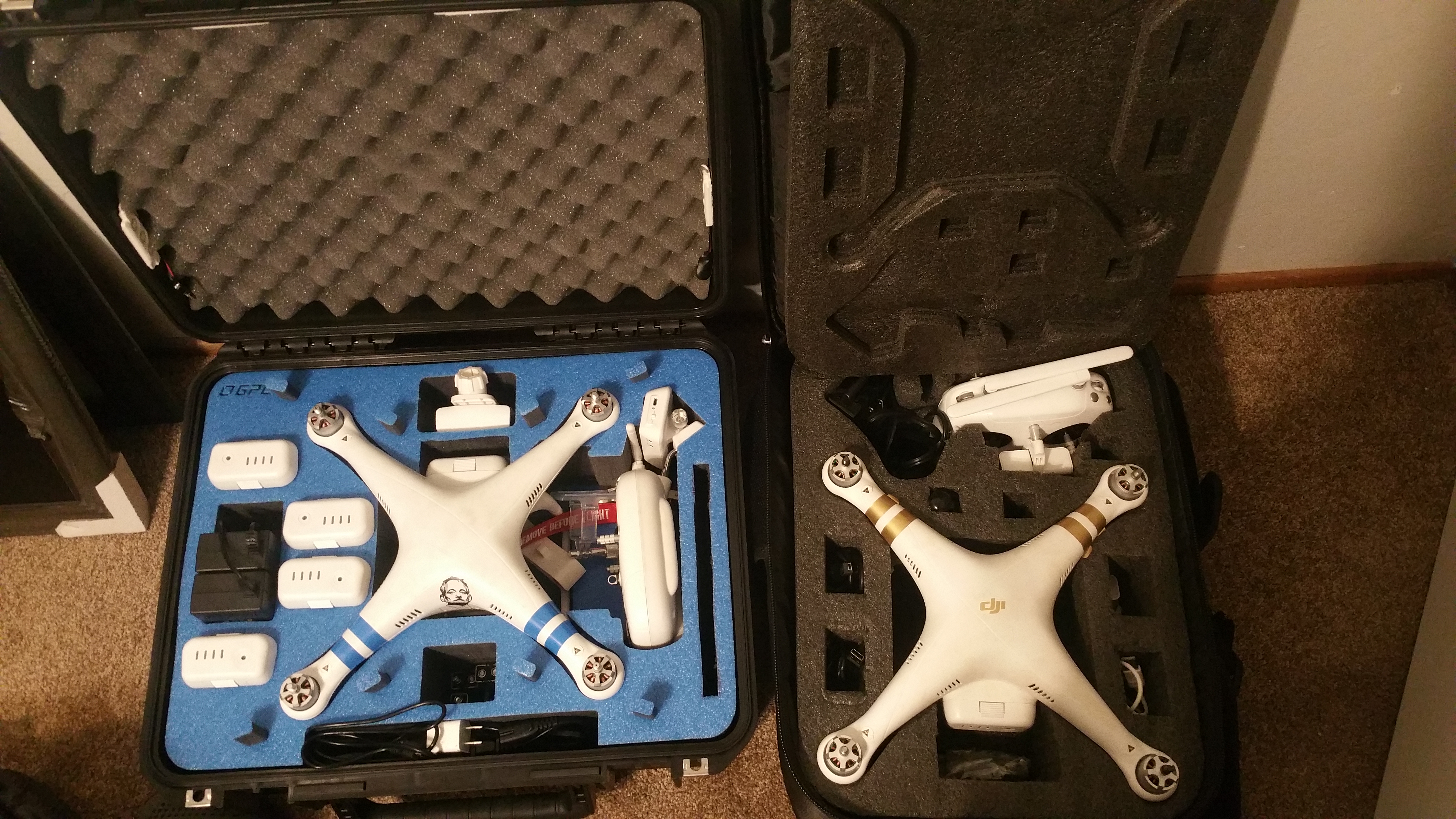

Thanks. I am shopping for a backpack, but it looks like there are some issues with the P3 being a bit taller than the P2. Hoping to find something that is a soft pack, but protects well. Seems like new alternatives will be coming out quickly.
For now, I guess I will drag a little mat with me to launch off of.

P3 fits fine in a P2 backback.

I use a P2 backpack which fits the P3P perfectly including the Nvidia Shield and my Launch pad which is just a piece of flexible type plastic and fits in the Backpack lid pocket.
