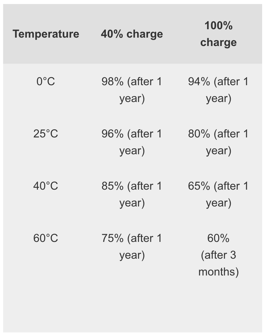

Two things that are well established as limitations of LiION chemistry are that ageing (capacity loss principally) is accelerated by elevated temperature and cell voltage. This is evidenced by research and various papers authored by cell manufacturers and independent entities.
A good resource is battery university. The following table is from their website.
The cease to function at 200 cycles claim is a myth. It may be more or less. The battery SOC (manufactured by Texas Instruments) uses an algorithm to determine battery health (life percentage) which is determined by actual measurement of parameters while at rest, charging and in use. The life algorithm includes cell internal resistance (one of the best indications of cell health) and actual usable capacity in the cell health determination. The remaining % and time to empty fuel gauging parameters as depicted in the GO app are within 1% accuracy.
