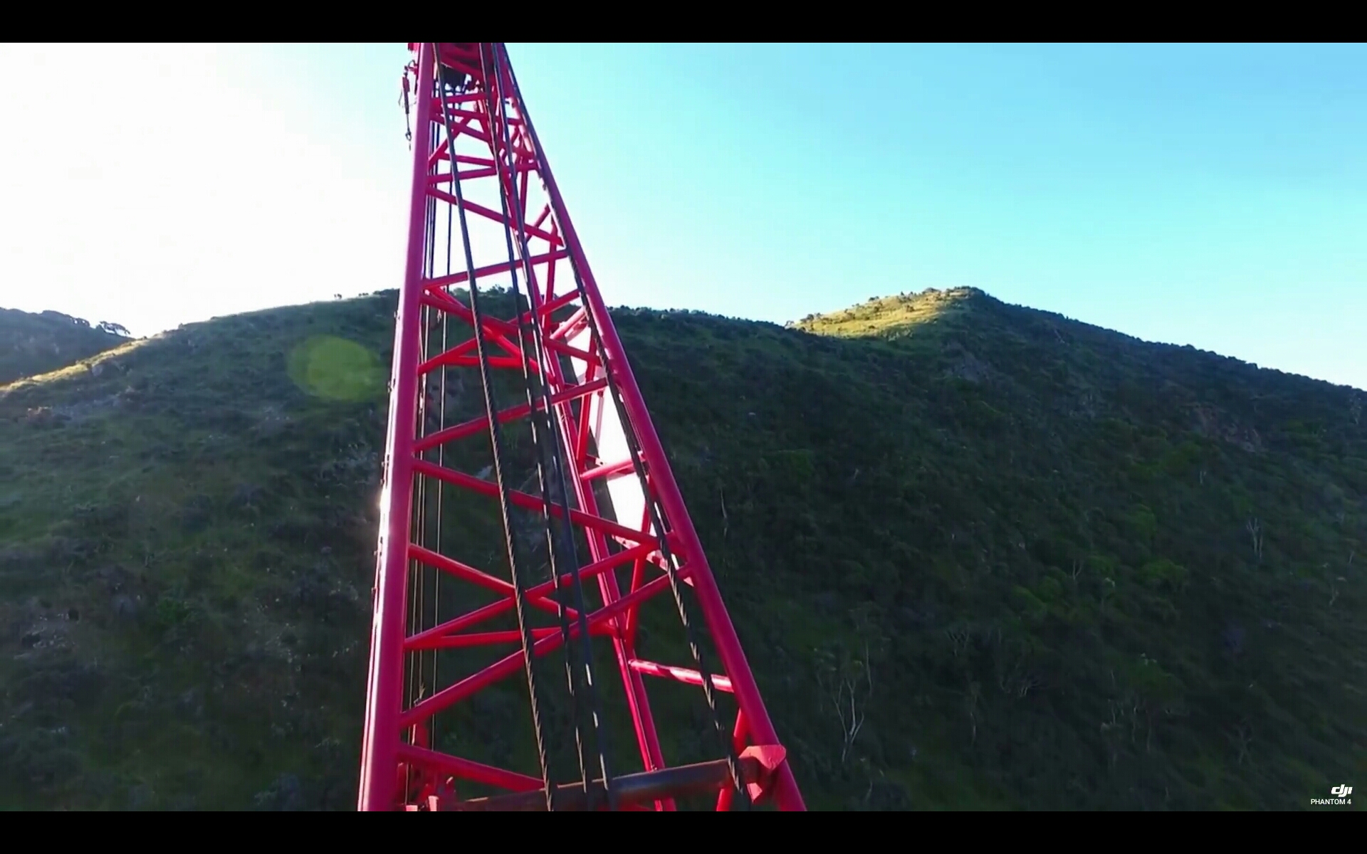

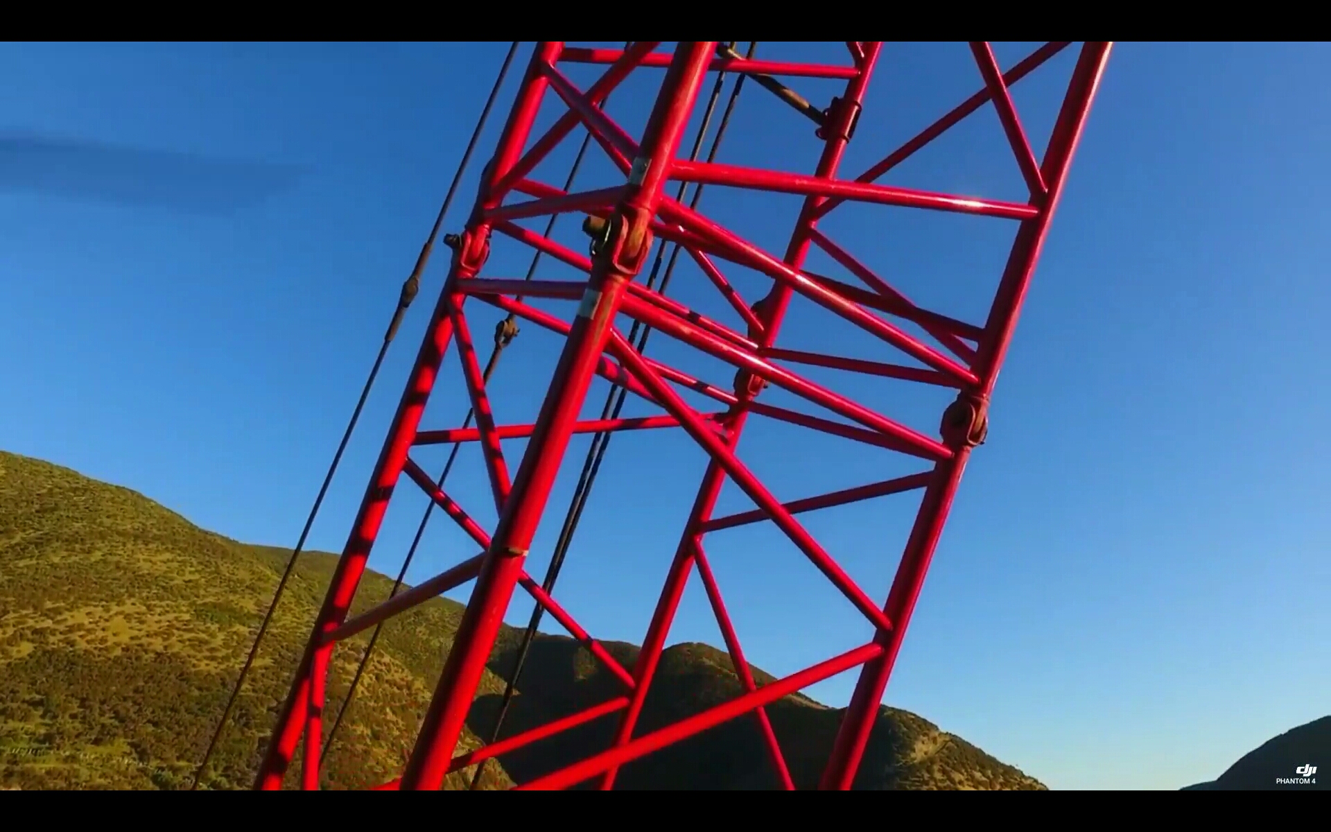

If you have good clean take off ,I say no worries, I buzzed this crane and had no issue but wind and I got close
,,,,,as can see
