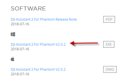

I've tried several times to login to the DJI Assist 2 in order to get the latest firmware update. (I'm currently running firmware version 01.02.0304). I downloaded this EXE today:
