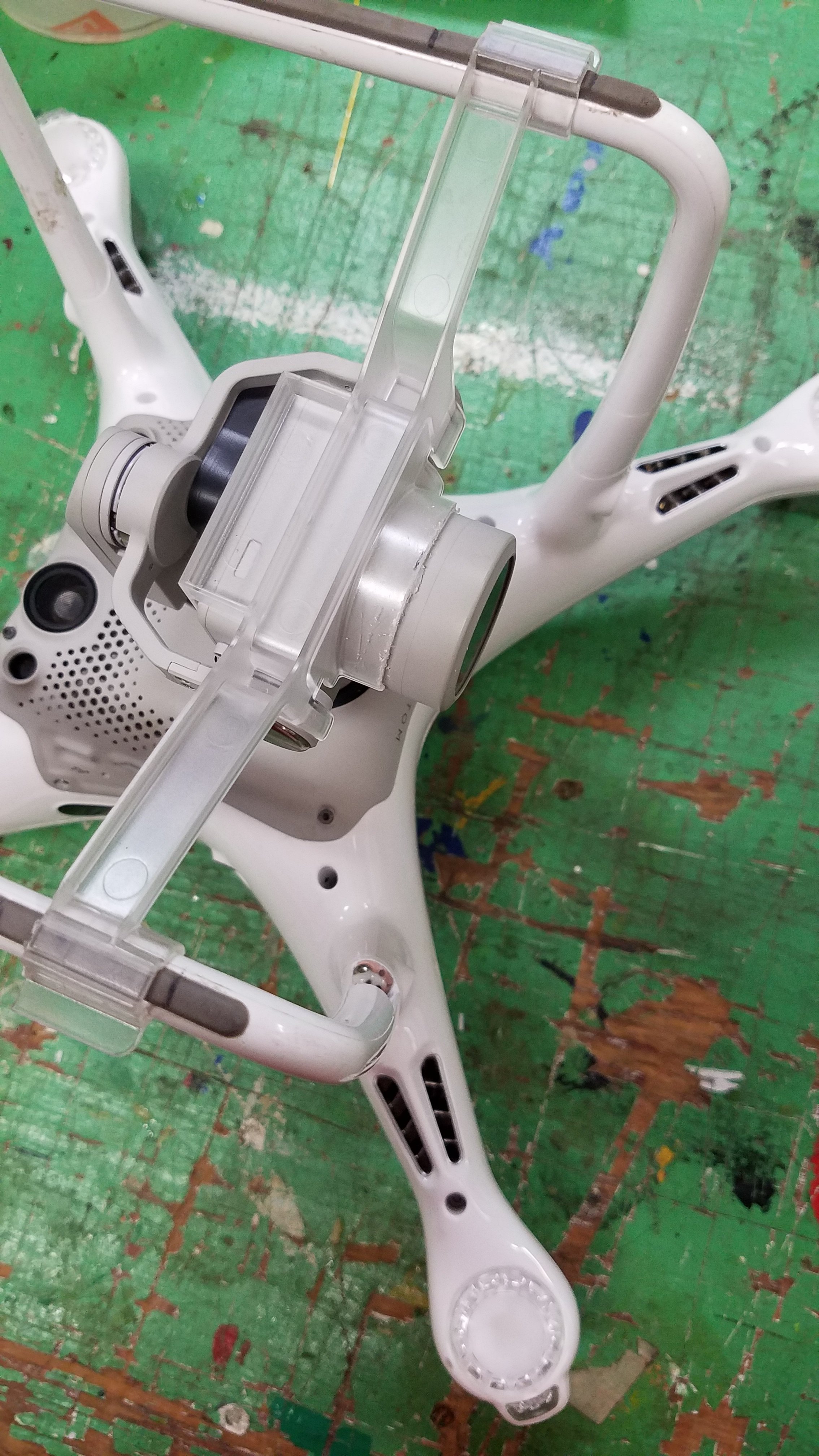

Had a spare camera bracket (from a drowned P4P shown). I cut it behind the line. Put it on the new P4P and holding it tightly in place with my left hand I twisted! Popped loose with little effort!
Wow great idea
