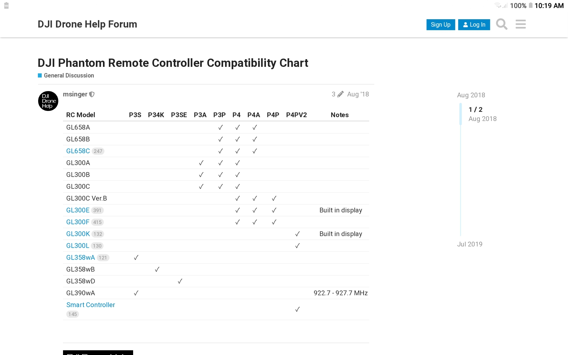

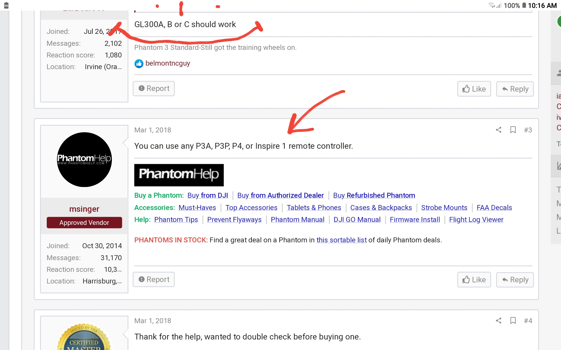

My P3 Advanced controller was damaged so I would like to be able to be able to use my P4 Pro controller instead.
,,,hope this help you,,might have different remote firmware so check all that
