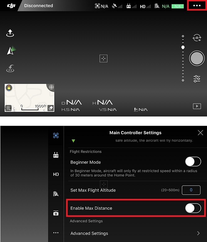

Sounds like 500M? Perhaps you enabled the "Enable Max Distance" option in the app which actually limits distance. Do you have it set to limit your distance to 500M? If so, disable the "Enable Max Distance" option so that you can actually go further than 500M / 1640ft.

When I went 1632 feet the dji program said you have reach maximum distance?
Here's the setting that should be disabled. Make sure you set it while your Phantom is connected to DJI GO.
