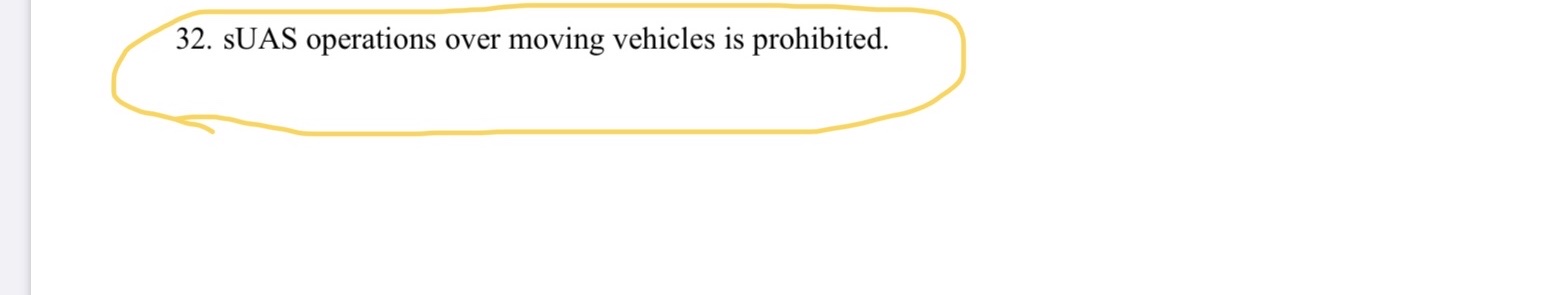

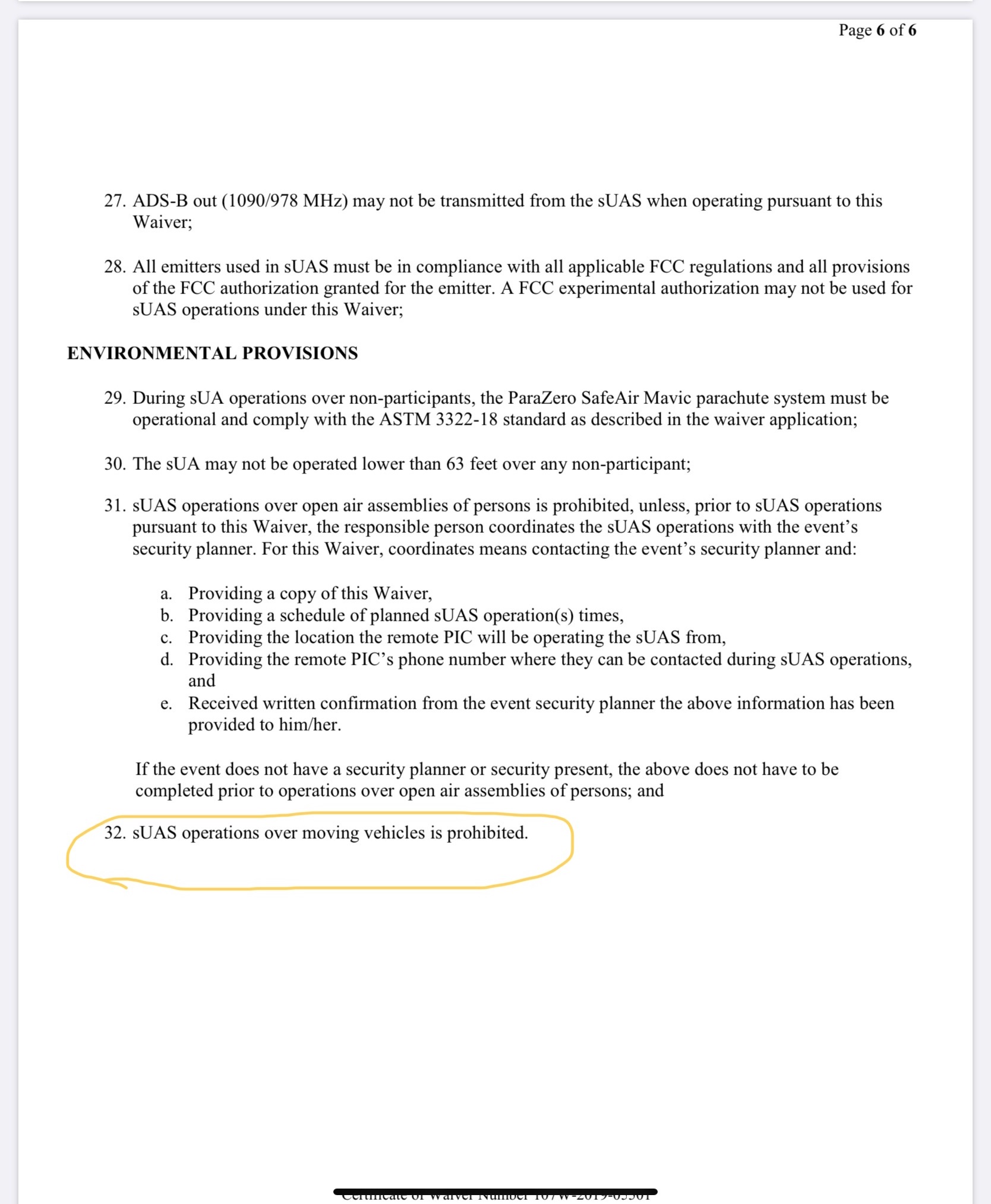

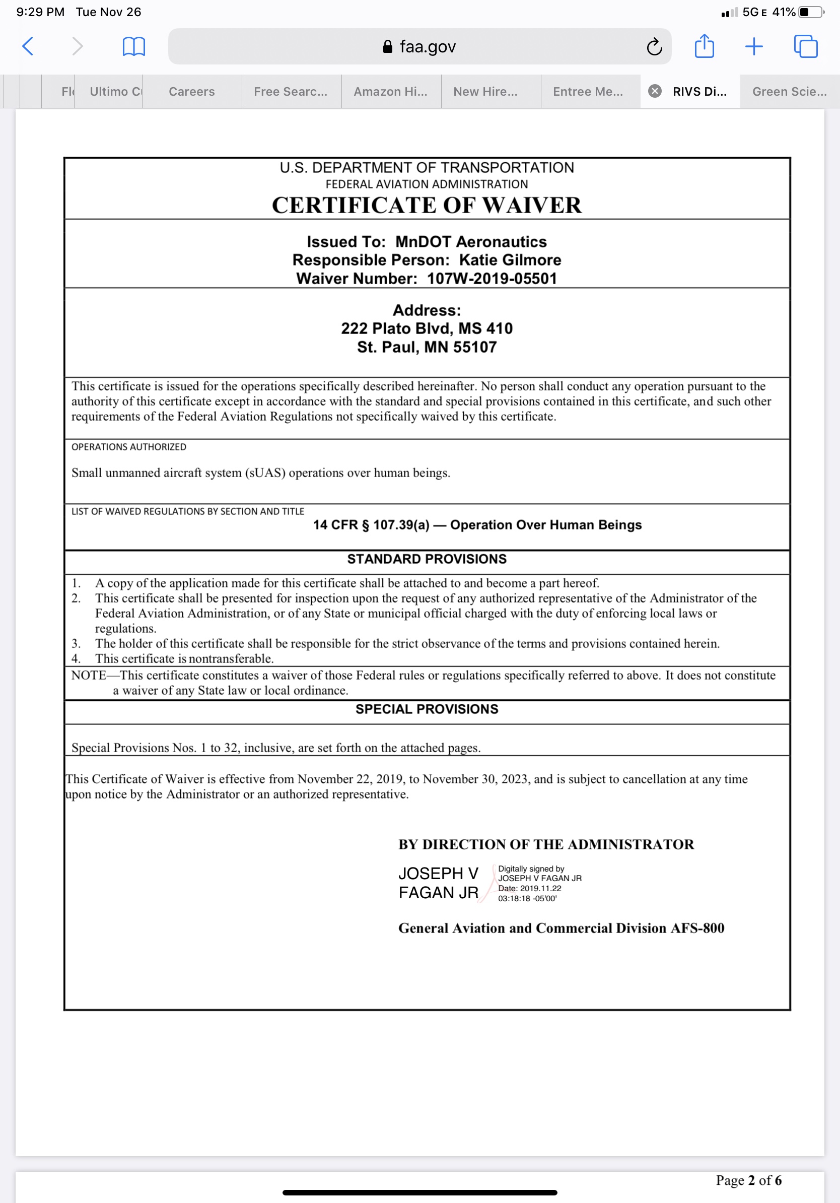

107.39 is for operations over human beings and is the only reg as far as I know where it states anything about flights over vehicles. So if I get a waiver for 107.39 would it specifically state that I could fly over human beings as long as they are not in a moving vehicle? Just asking for clarification.
Did my own research and here is what I found on the last 107.39 waiver issued.
