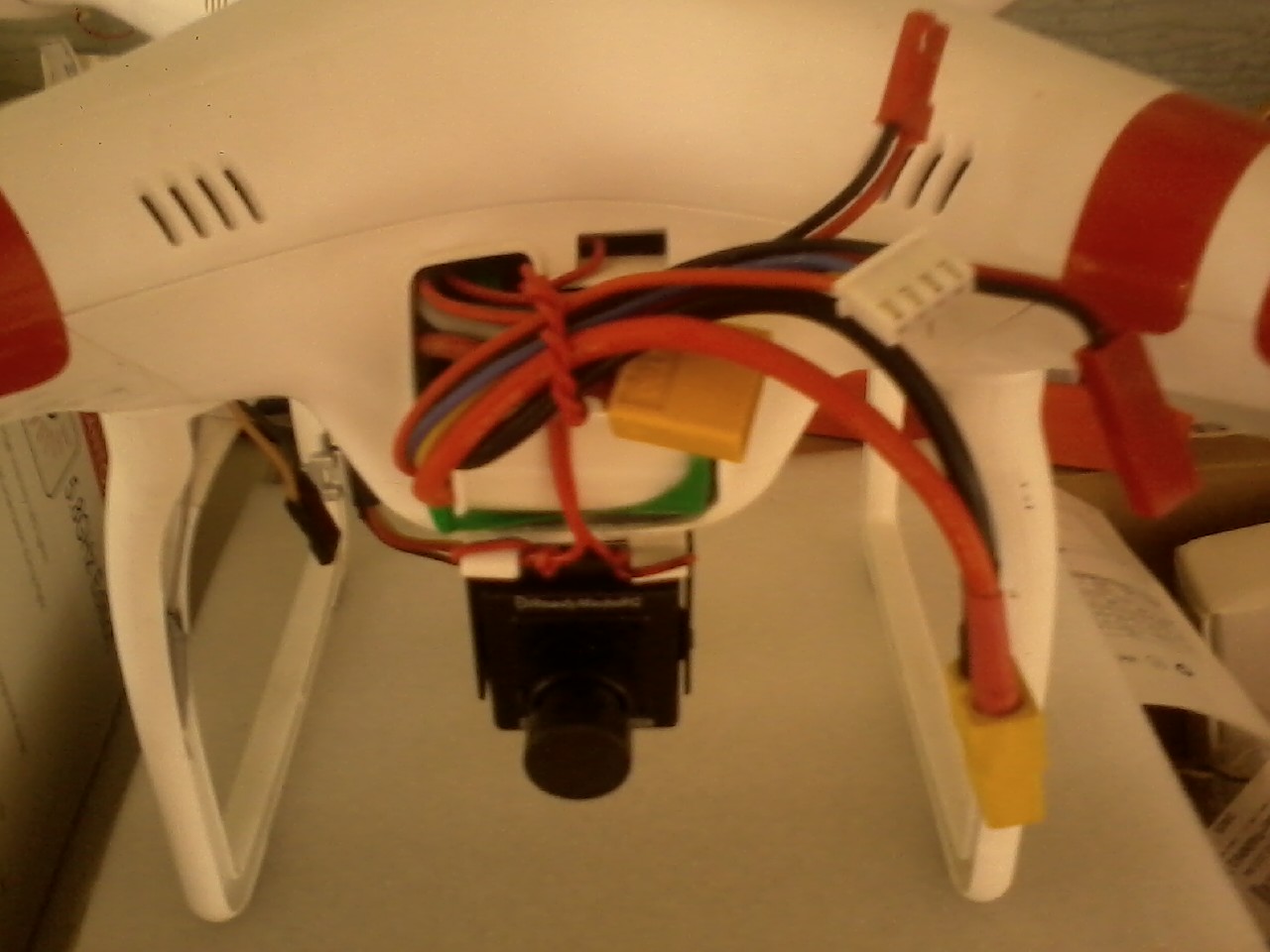

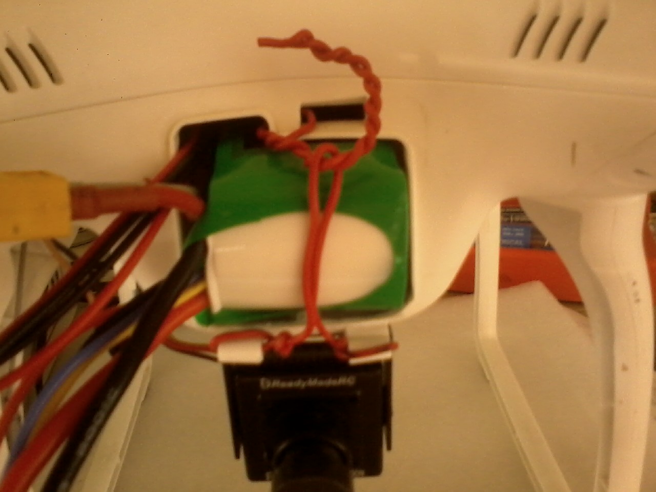

I removed the battery door completely and have 2 pieces of wire holding the battery in. I think it's 20 awg solid core copper.
The extra airflow should help cool off my transmitter too, I hope.
View attachment 18367 View attachment 18368
