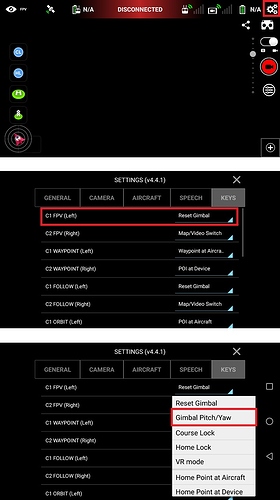

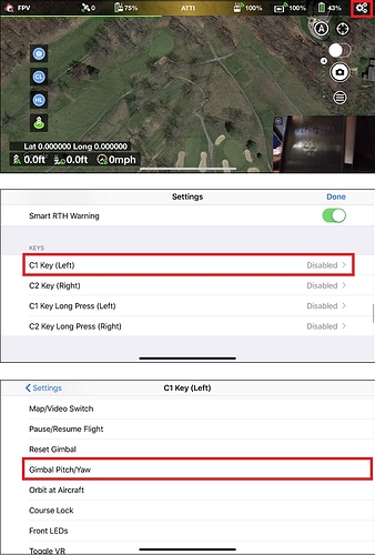

If the above remote controller reset doesn't work for anyone, Litchi has a setting for the C1/C2 buttons that will toggle the camera between tilt/yaw. Install Litchi and configure that setting in the following section of Litchi:
For Apple devices:

For Android devices:
