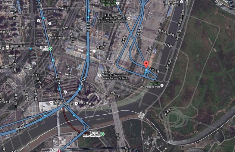

I'm a geocacher and my friend goes to China mainland then he said the maps is shifted from satellite (aerial) photos. I don't know why this occurs - if Chinese government intentionally provides shifted data for security, google don't use that provided data ("(c) google" can be seen in Chinese maps). Anyway maps and satellite offsets like;
https://www.google.co.jp/maps/@39.9181434,116.3959881,15.91z?hl=ja
https://www.google.co.jp/maps/@39.9181434,116.3959881,1441m/data=!3m1!1e3?hl=ja
Also I don't know how DJI knows the offset data.
This won't work out of China mainland, so both on/off OK... Me? I turn it off, of course. :-)
maps and satellite photos not same..
View attachment 28471 maps and satellite photos not same..

Google maps is available in China,
but using coordinate sistem GCJ-02,
all other country using WGS-84 coordinate sistem...
that is diferent...
that is reason why DJI have China calibrate coordinates...

In addition to Google, and Bing Maps and Apple Maps respect Chinese laws and use GCJ-02, but not the Open Street Map, which is therefore illegal in China, according to the Google Earth Blog.
