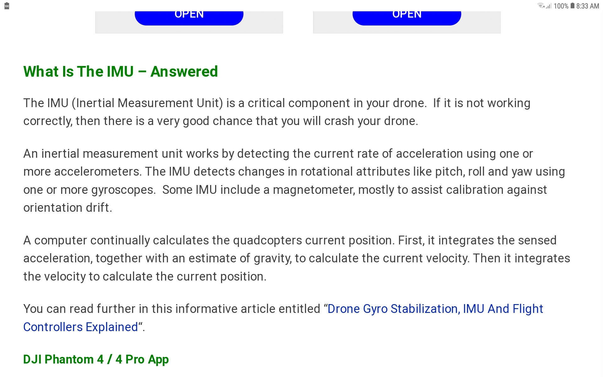

An Inertial Measurement Unit (IMU) is an electronic device that uses accelerometers and gyroscopes to measure acceleration and rotation, which can be used to provide position data.

Imu
Did you get a message that indicates a problem or some form of odd characteristic in flight?
No message, but I still have yaw drift that make still photography difficult. I calibrated the controller sticks, but wanted to learn more. What a shame that these aircraft controllers do not have trim pots to fine tune the crafts ability to hover still. The drift is very unpleasant.
I don’t believe you’ll be able to remove the drift via an imu calibration.
