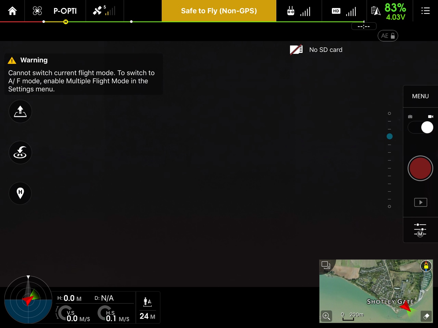

As I hope this picture explains- I don't believe that I could have set the controls to ATTI as the settings wouldn't have let me.

Well interestingly enough i can tell you I experienced a similar issue. First thing is go to your settings and make certain you are not in the beginner mode. Second you have to enable multiple flight modes. The default settings lock out the other modes. To enable go to the DJI GO app, enter the "Camera" page, and tap "Mode" then activate "Multiple Flight Mode."
As far as the system jumping from GPS to Atti (attitude mode where the aircraft only uses the barometer to stabilize) I don't know. The same thing happened to me. It was only about 20 feet away and I believe it had to do with the compass. I had calibrated the compass for the first time.. Maybe i did it wrong.??? No matter it did result in an anxious moment on the first flight though. As I realized the aircraft switched over to ATTI on it's own and started to drift. I was not prompted to calibrate the compass but I did it anyway. No more problems.
Definitely not in beginner mode and it is locked in multiple flight modes under settings.I guess this must have gone back to this after the firmware upgrade as I have used POI etc before but not recently.
