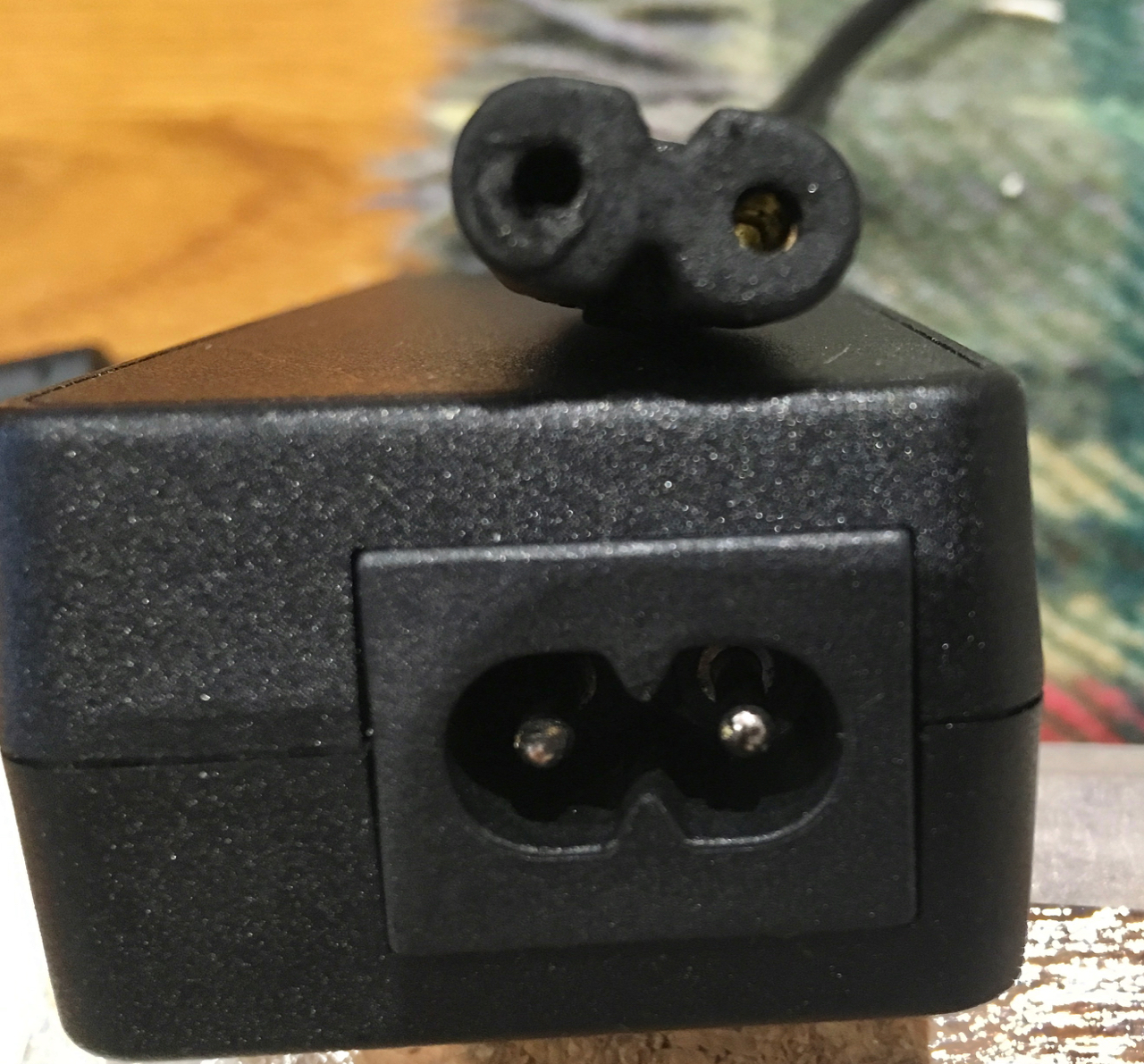

After this morning's flying, came home and charged up the batteries - as you do!
When the first was charged I turned off the charger, disconnected the battery and plugged in the second. Turned on the charger again, battery lights blinking as they should and left it to it.
Luckily I had to go back into the room again and could smell burning, well certainly overheating.
Turned off the charger and checked and found that the mains socket that plugs into the charger had worked its way out a bit, probably when I changed batteries. Initially it was just making enough contact to start the charge but must have started sparking and heating the contacts.
Always check all plugs/sockets are fully engaged EVERY TIME!

My charger is OK, cleaned it up, and tested it with the plug fully inserted, and all is well. Kept a finger on the plug while charging the second battery to check its temperature and no sign of overheating!

After this morning's flying,......
, View attachment 109845
