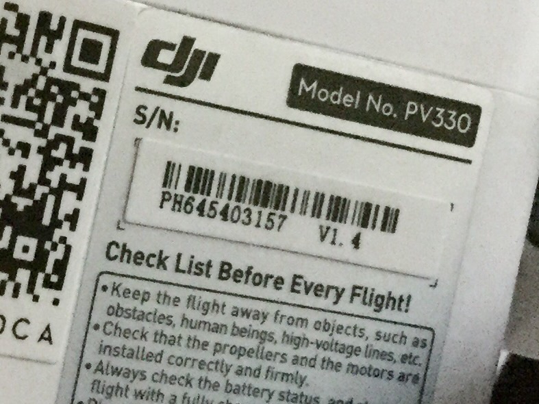

Quick question, do your birds have a lot in common in terms of when and where it was built? Mine is a P2V version 1.4. I know it is older, and it sat on some shelf before my wife, I mean Santa, got it for me. Could we compare serial #s? I know there are threads out there dedicated to this and they did not uncover much. But I was wondering your setups...
My Serial # is PH645403157 and like I said, it's a V1.4

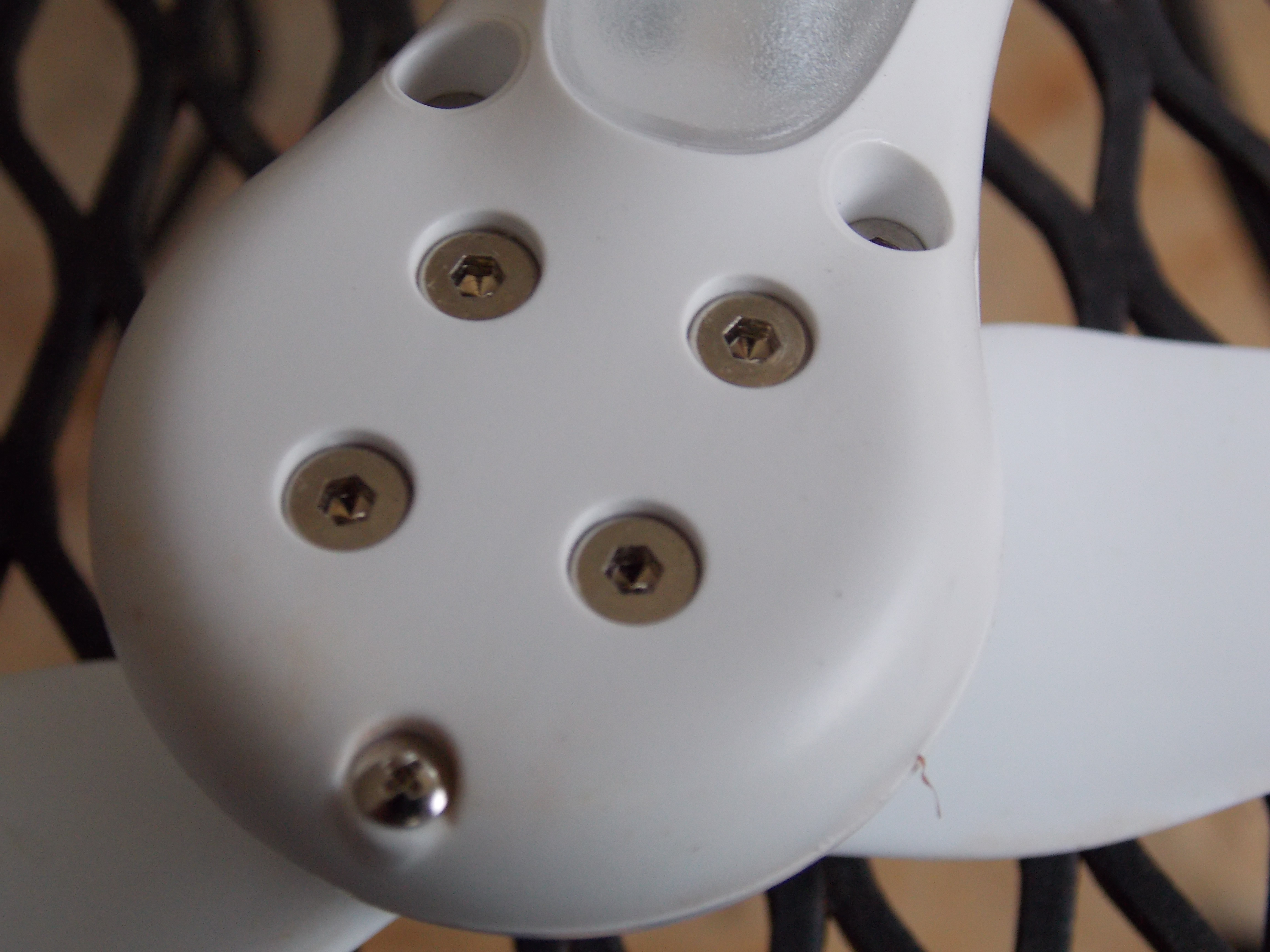

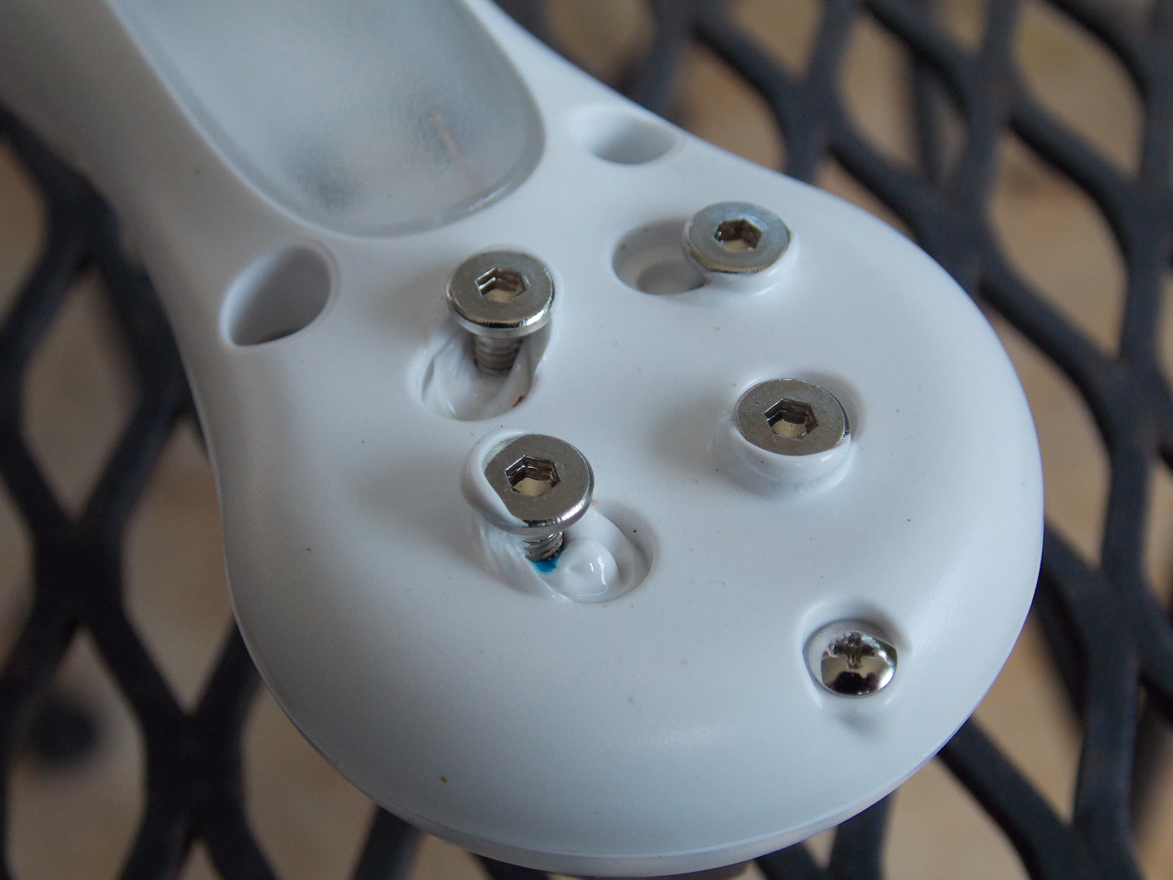

Let me tell you my story. It might help you out. My first flight I hit a tree about 400 yards out. the Phantom went down hard enough to knock the camera completely loose. I hit the controls to kill the motors but the bird apparently didn't get the command. When I found it two motors had badly overheated. Here's the worst part. In addition to two motors and one ESC I had to replace the shell. the bottom half at least but you have to buy the entire shell. where the motors mound to the lower shell the plastic melted enough to distort the mounts. In all 2 motors, two ESCs, one shell and shipping from China was about $169 USD. Be sure your mounts aren't distorted from the heat. Swapping all of the guts (circuits and motors) over is not hard if you're handy with a soldering iron. I'll try to upload a few photos of what the overheated motors did to the shell. Ok. added the pics. The motors would have been out of alignment with the old shell and would have made flying almost impossible. You can see the distortion in the mounting screws. Look yours over. If you need the shell I can walk you through the switch of the guts. Each motor is wired differently to the ESC. And remember you have two CW and two CCW motors so be sure to order the right one's. My entire change over took me about two hours. Good luck.
View attachment 24738 View attachment 24738 View attachment 24737
Wow! That is some serious heat! Glad you are back in the air again.
That one was Hot ! My first one that had to have a new shell was just 1 motor that was stopped while the others spun and it didn't look like that from the bottom but like this under the motor motor d1.jpg . Motor just looked tilted and when I looked this is what it looked like .
