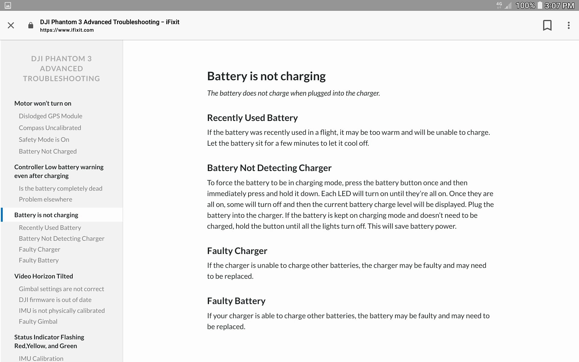

Did find couple of Maybys ,I know one says p3a but they use same battery,you can do 5 sec hold test on power button,it should make all 4 light up if good batt,3 bit tired 2 get ready to replace etc,
,,,,,,mayby consider replacement,,was drone a new purchase it be covered by store or dji care,mayby seek a exchange one,,could just be a faulty battery
Reactions: steve 604
Did find couple of Maybys ,I know one says p3a but they use same battery,you can do 5 sec hold test on power button,it should make all 4 light up if good batt,3 bit tired 2 get ready to replace etc,View attachment 101000 View attachment 101001,,,,,,mayby consider replacement,,was drone a new purchase it be covered by store or dji care,mayby seek a exchange one,,could just be a faulty battery
