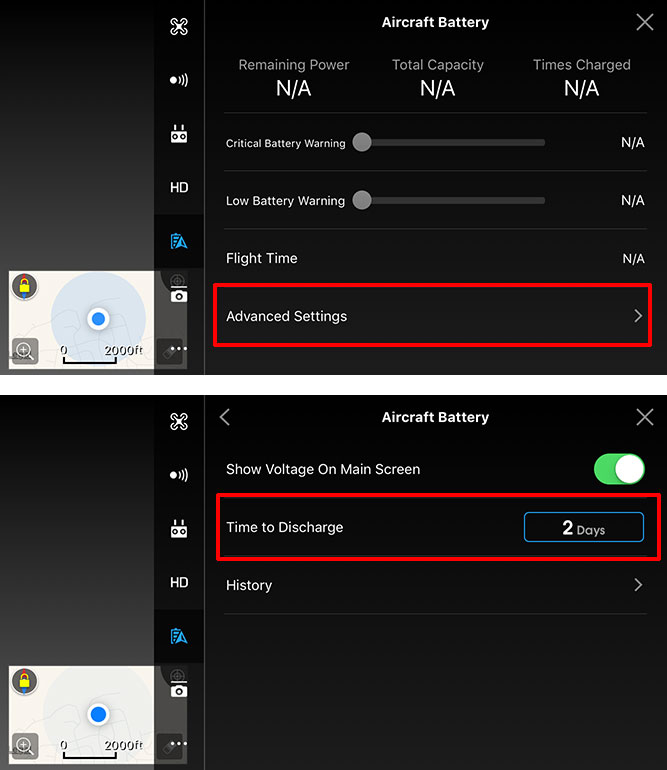

Li-Po batteries can be damaged by storing them fully charged for long periods of time.

FYI, if you're checking them by pressing the battery power button, the discharge process will stop and it won't restart for 3 additional days (per your selected setting).
I have a rather unique problem. I take canoe treks way up in Northern Canada. I will be going up this summer for a couple of weeks and bringing my new Phantom 4 Pro. I want to be able to use my batteries after longer than 10 days of storage, the maximum the software allows before automatic discharging. DJI is telling me in their chat room that there is now way of going past the 10 days. Will your method work? In other words, if I depress the power button on day 10, can I get it to cycle for another 10 days? I will simply have no way of charging the batteries when I am up there and I have 4 of them.
Yes, the 10-day counter will be reset each time you press the battery button.
Thank you for that. Just one final thing. So do you have to wait for it to start discharging to push the button or will pushing it on day 9 add another 10 days if that is what your setting is?
Pushing the button will restart the countdown timer. If you have it set for 10 days and you push it after 4 days, then it will be 10 days from that point in time that the discharge will begin. If you push it after one day, then it will be 10 days from that point in time that the discharge will begin. If you push it at 9-1/2 days, then it will be 10 days from that point in time that the discharge will begin. etc, etc...
On the subject of battery discharge, I know mine are set for 10 days as well. I came home after being away for 11 days and noticed none of them had any discharge. Thoughts anyone's?
That means your batteries would have started to auto discharge 10 days after they were last used and/or the battery button was pressed. It'll take an additional 2-3 days beyond that 10th day to auto discharge the battery down to the storage level if it's fully charged.
Great Thankyou. I'm assuming from what you're saying is that it's a slow 2-3 day process after that 10th day.
