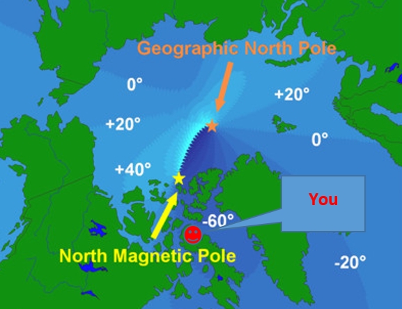

The compass will be a problem both because you're close to the pole and because of the metal content. This is why it doesn't like launching in any mode, because it thinks it isn't safe to do so.
Honestly not sure you can do anything about it apart from moving hundreds of miles away from the pole, which I guess kind of defeats the point! Hope you get some footage, must be a challenging but amazing place to be.
Interesting... I just don't think you should be having GPS problems there, but totally believe you would see some compass issues.
I did a lot of flying this past summer in the Arctic at 67 N and had no issues. GPS is truly global and with the ability of the P3's to also use GLONASS satellites this really helps in the Arctic with satellite reception. I've worked at your latitude (though not flown P3's there) with survey equipment and did not have issues with satellite reception so I don't think you should be having issues tracking satellites unless something is wrong with the unit. But I totally believe you could have compass problems because of your vicinity to magnetic north.
Looking at your location you are really really close to magnetic north. Probably very confusing to the P3 since earth's magnetic field gets less consistent and more divergent as you approach the magnetic pole. Where I was flying in the Bering Sea off NW Alaska the latitude is fairly high but it is further away from magnetic north and probably allowed for a stronger and more consistent pull on the P3 compass.
Not much can be done about this since I'm not sure what government or international agency is currently responsible for the geo-location of magnetic north. Magnetic compasses are cheap so it is understandable why DJI would use them. Gyros work well at high latitudes but would be cost-prohibitive.
Try turning the Phantom 10 degrees at a time. Watch your MOD value and see if it gets closer or further away from 1400. If it's getting further away, turn it the other way. That might be enough to get rid of the compass error.
Alternatively and slightly risky, you can introduce pieces of metal around the Phantom to raise/lower the mod value to get it within range.
No matter what, only fly in ATTI! The compass error will probably return as soon as you get in the air but at least you'll be able to fly. If you see really bad horizontal stability on the gimbal, there's a risk the bird may not fly perfectly level or may begin to lean in one direction. Keep an eye out for this.
