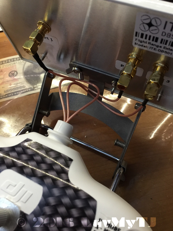

I personally chose the DBS panel for mine as it had much better reviews than the Argtek. I also did not drill any holes to install it so if that is all that is stopping you don't worry about it. I did it that way to see if it could be done and it can be. Besides, what difference do a few holes make, once you take off the original cables it isn't virgin anymore! :D

Could you post a picture of the install without the holes, I plan on getting the DBS soon and would like to see how its done without the holes.

Those RG178 cables are only rated for 3GHz max. You need 5.8GHz cables for the control.
