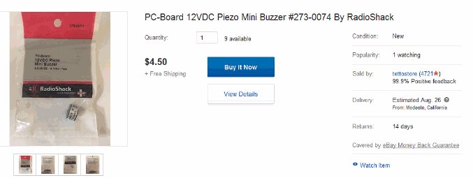

I used a 2-wire pair wire stripped from an old IDE hard drive cable to wire the buzzer. It's tiny, and is very handy for a lot of small connections. The buzzer has to draw <10ma so as to not overload the output of the IC. You do need a tiny iron, magnification, and a steady hand to solder the wire to that resistor. You won't get much distance on the buzzer if ambient sound is loud, but anything is better than norhing.
You can buy it on ebay for $4.50 w/ free shipping. I picked up a few.
http://www.ebay.com/itm/like/231608421027?ul_noapp=true&chn=ps&lpid=82

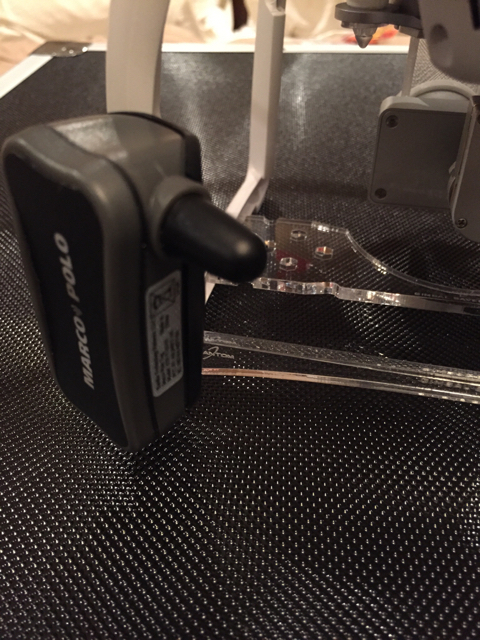

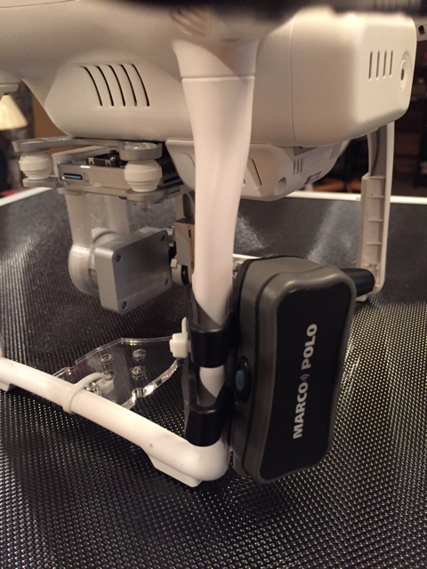

Here's where I have my Marco Polo Tracker attached.

Got the dog one did ya? Is it a lot heavier?
LOL Yeah I know. It's not been a problem at all, it weight 1-3/4 ounce and has made no difference at all in flying or staying (hovering) stationary. I wasn't sure when I picked it up but seems to work great.

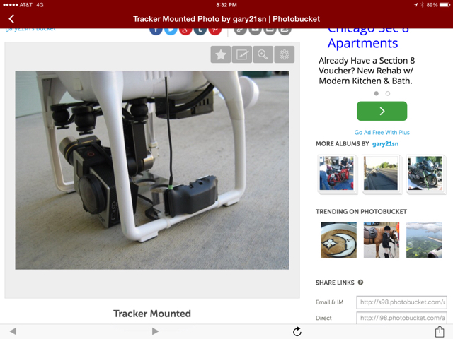

I haven t mounted mine yet. Just got it in days ago but I was thinking about this guys setup with a plastic corner molding from the hardware store
