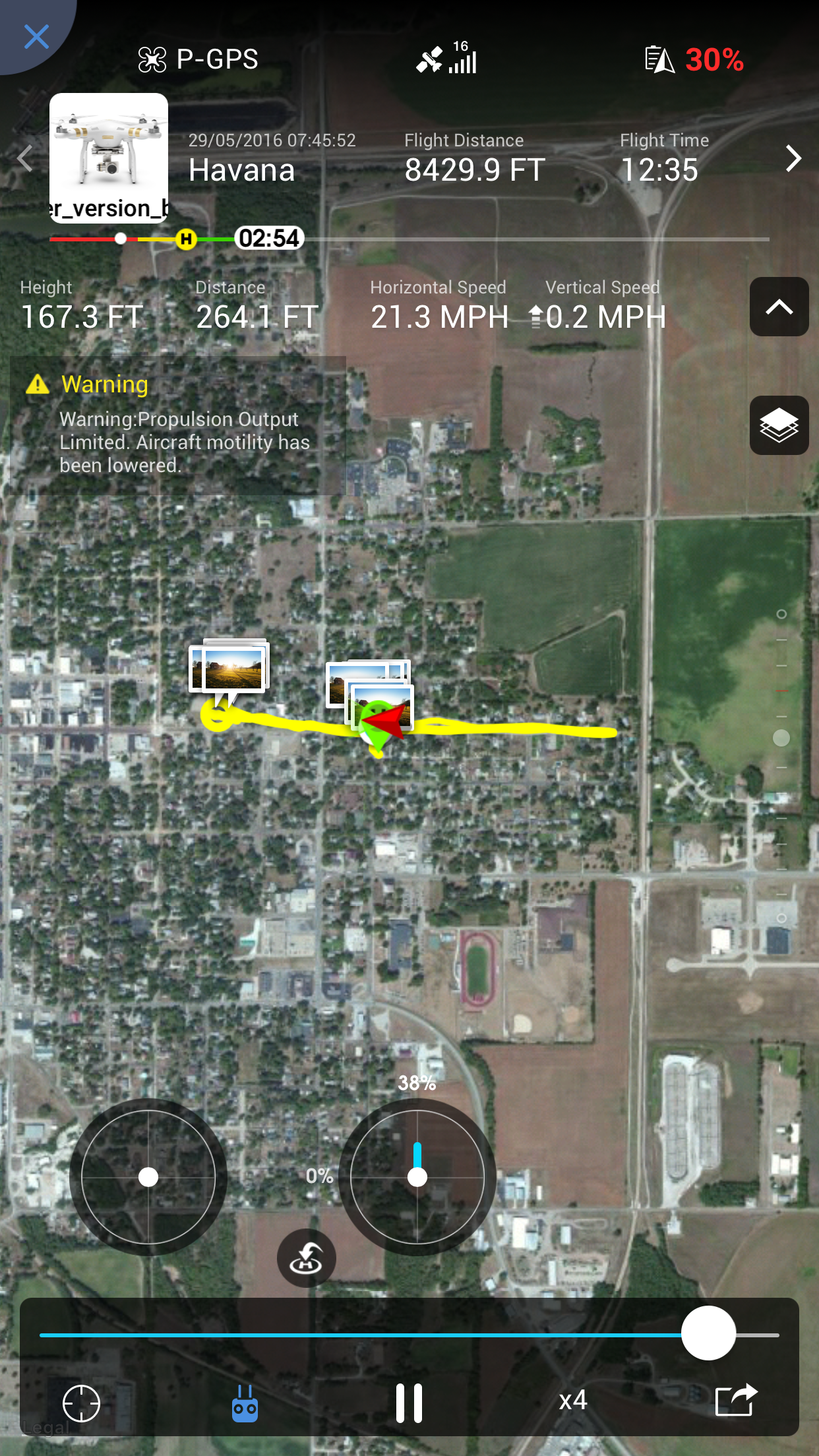

I had the same warning with my last flight this past Sunday, May 29th. (Just after I updated my RCs firmware to 1.6). I have attached an image of when the warning took place I took off with 97% battery. All firmware updates have been successful. Why did I get this warning with 30% battery remaining?
I flew the day before with no issues, even though I had a warning to upgrade the RC which had been done previously. I finally got the 1.6.0 version to stick, and my first flight I get the propulsion warning.
Here is my HealthyDrones Link for the data.
Please advise!!
Nervous to fly again!!

I'm not sure why you are worried. You should be happy I think. You said yourself that you were already down to 30%. The warning was telling you that you triggered a combination of low voltage levels and flight maneuvers that could have led to something bad. That warning is telling you effectively that it is saving you from yourself by not letting you draw more from the battery than it could give in its depleted state.

But why now? As a rule, I usually land at or before 30% battery, but I have flown down to 10% before with no issues. On this day, the wind was very mild, and I was not pushing my Phantom 3 Pro hard at all. It was only after the RC update that I received this warning. Never had the warning before with lower battery percentages and working the P3P a lot harder.

It's no big deal, I believe it was part of the 1.6 update to counter the drone falling out the sky if battery temp dropped, then the drone would just cut out and fall out the sky. What I don't understand is the that the propulsion has been limited warning, why is this, is it because the batteries are over heating, likely when drawing current or that they were too cold in which case you don't want propulsion limiting at all, in fact you want more

Because you exceeded one or more of the safety parameters that DJI implemented with AC FW 1.6 as a fix for the debacle of AC FW 1.5. With a 30% battery, it is highly likey (almost certain) that the software encountered conditions which would drive battery voltages too low. It then limited output as designed. It is normally acceleration or ascension with a depleted enough battery that leads to triggering this safety protocol. The Phantom calculates the potential to reach a critical voltage level, so it forces a slow down in propulsion. I can only speculate since I dont know all of the environmental conditions or what your stick commands actually were at any given moment. Nor do we know precisely what DJI has set as parameters or how they calculate for potential issues.

That's what I thought too, but Sunday morning, I had a warning that there was a new firmware for my RC. It took me two different attempts to finally get the update to work. How can my RC back date itself? Very strange behavior indeed! As for conditions, they were perfect! Very little wind, mid 70s, 7:30 in the morning. Great flight except for that tiny scare toward the end when I was bringing it back to land it.

This happened toward the end of my flight, and my battery temp was at the highest it has ever been, 132.7 degrees fahrenheit. (See image attached.) I just think it's very strange behavior. If DJI implemented this as a warning, I wish they would have listed a set of parameters in which this warning would appear.
