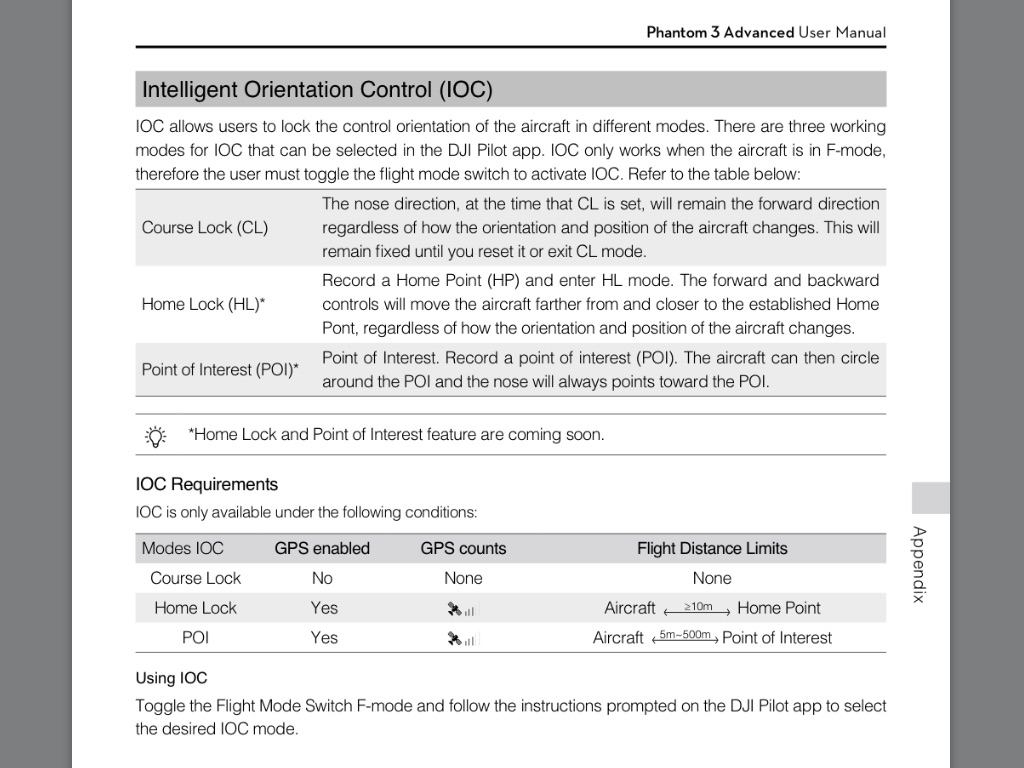

My biggest complaint is the lack of batteries and Home Lock. I hope this is remedied soon. View attachment 19545
POI might be nice, but I miss Home Lock.
I totally agree on the Home Lock! Hope it is soon....
