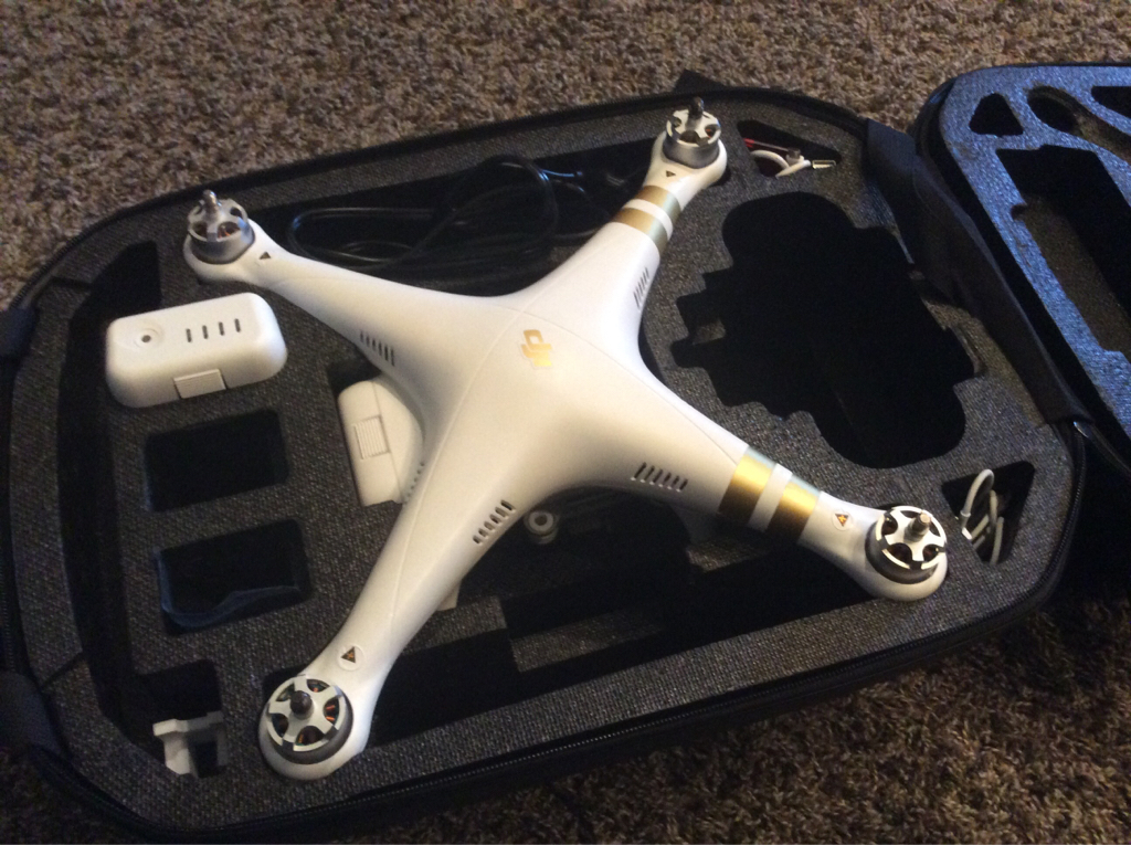

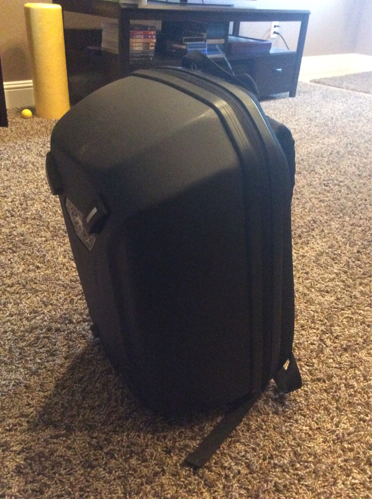

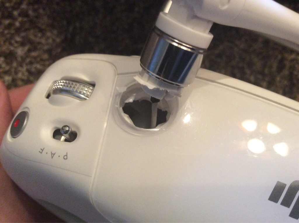

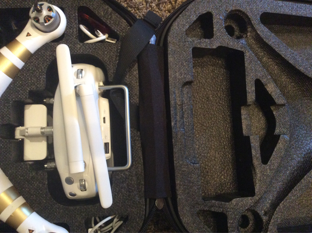

    I've only had the Phantom 3 for about two weeks and one of my antenna broke. I have the dji hard case backpack. It's awesome. Packs everything tight. Though a problem is the spot for the antenna is really tight. I must have had the stick off just a little bit when closing it. Actually I didn't even close and zip it I just put the flap on top and put the bag in the corner
    You can see by the photo that the plastic is very thin on the controller. Be careful everyone. If for sure my fault but that plastic is surprising thin. If you have this bag be aware as well.
    I really don't want to send it in so I guess my options are tape or super glue. Ideas anyone? ImageUploadedByPhantomPilots - DJI Phantom Forum1444324505.157241.jpg ImageUploadedByPhantomPilots - DJI Phantom Forum1444324519.873044.jpg ImageUploadedByPhantomPilots - DJI Phantom Forum1444324531.782699.jpg ImageUploadedByPhantomPilots - DJI Phantom Forum1444324590.832114.jpg

    I wouldnt use super glue or tape, use two part epoxy. Even the 5 minute stuff you can get at your local hardware store is fine.
    If you want to get fancy, you can order plast-aid. Mix it up, wait for it to go from liquid to the "putty" stage and then apply it, smooth it, sculpt it. I got some to reinforce my shell before it cracked and it works great. and should have it looking relatively like new.

    Its crazy how thin the plastic is on the controller. A couple of people have even posted that the screw bosses holding their sticks have broken.
