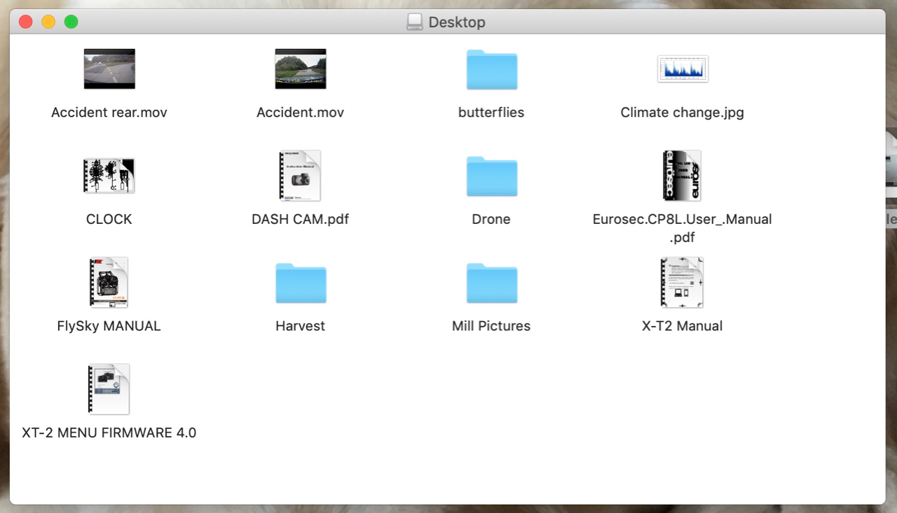

Very odd. I followed the instructions and a file appeared ion my Desktop labeled "Drone Files.dmg.
After about twenty minutes I got "operation completed" in the disk utility but when I open the file all I get is a copy of my Desktop? See screen shot.......
So where are the files from the drone

I think I have found the issue.
In the tutorial they say "To do this, select the SD Card, then File>New Image>Image from Folder." I saw the "folder" and selected that instead pf the "DJI FLY LOG". Now it's copying that over, about 3.97Gb so will take a few minutes!

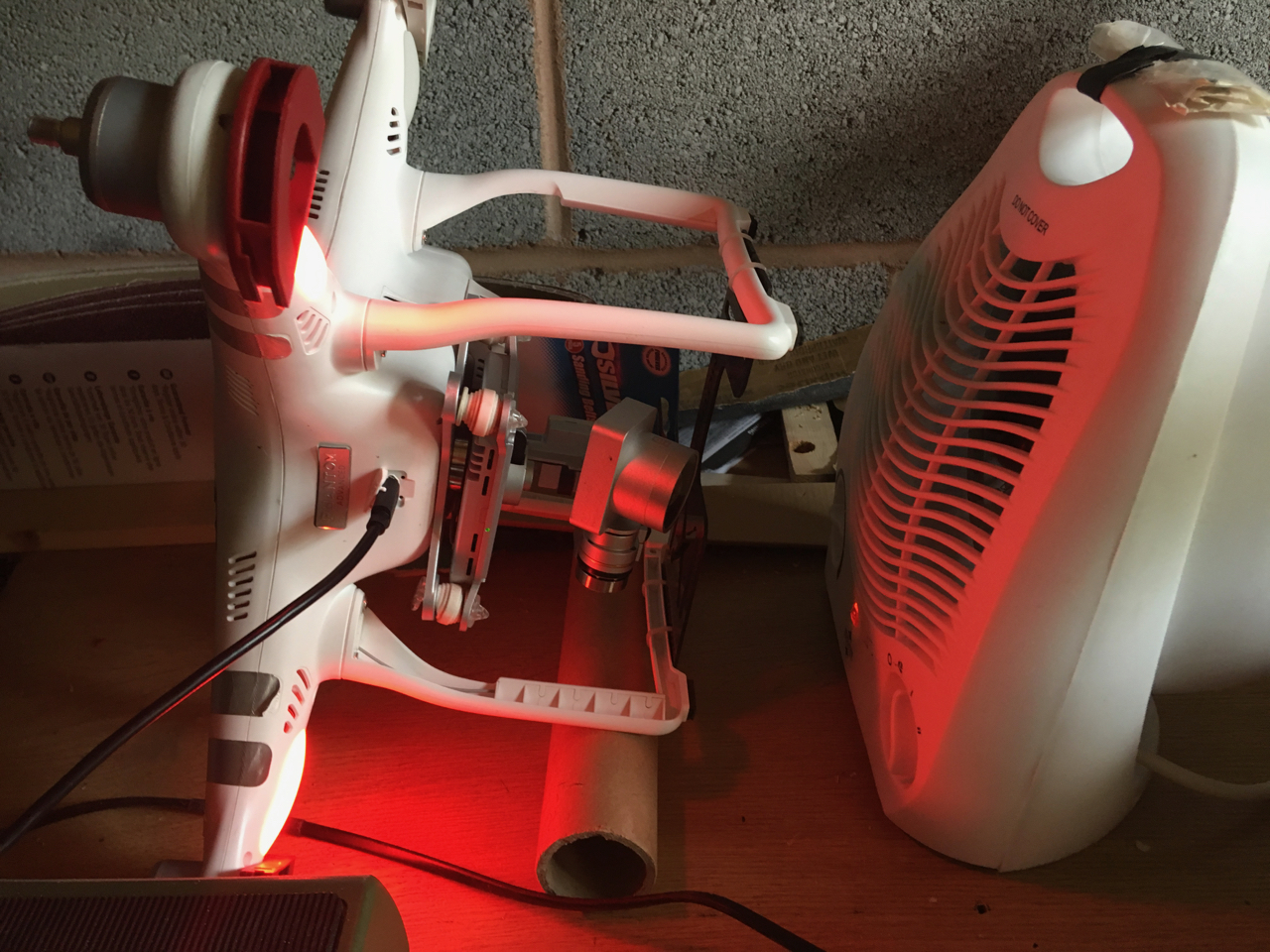

One thing to think about is keeping the gimbal top (main) board cool during the extended period of it being powered up during the download. I know you have a P3A which is less vulnerable to overheating damage than is the P3P, but if it were mine I would still play it safe and use some sort of external fan during the process. Perhaps a bit paranoid yes, but since it's so easy to do why not right?
Reactions: JoBe
Yes it is getting a tad warm, as is the VPS module! Haven't got a convenient fan so fingers crossed it doesn't burst into flames!!
Moved from living room to garage AND put a fan to use.........

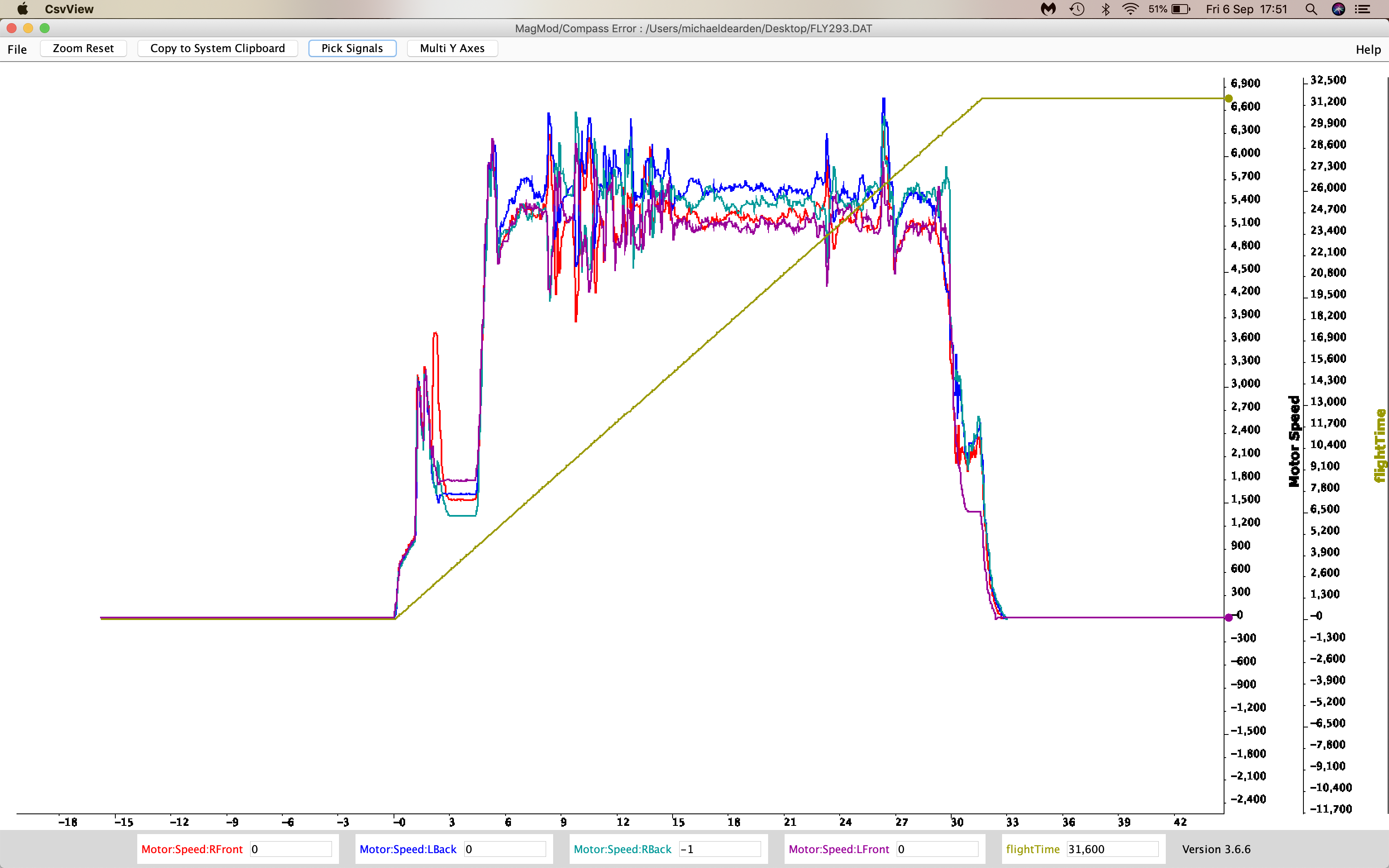

Just a short, random, incident free flight the other day, graph showing motors and altitude.
You cannot imagine how pleased I am that I've actually done this! Now for some practise on bigger files, longer flights :D

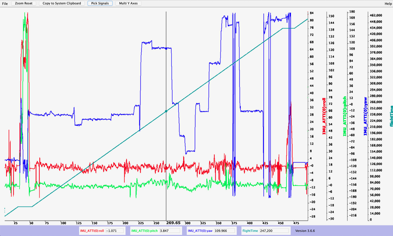

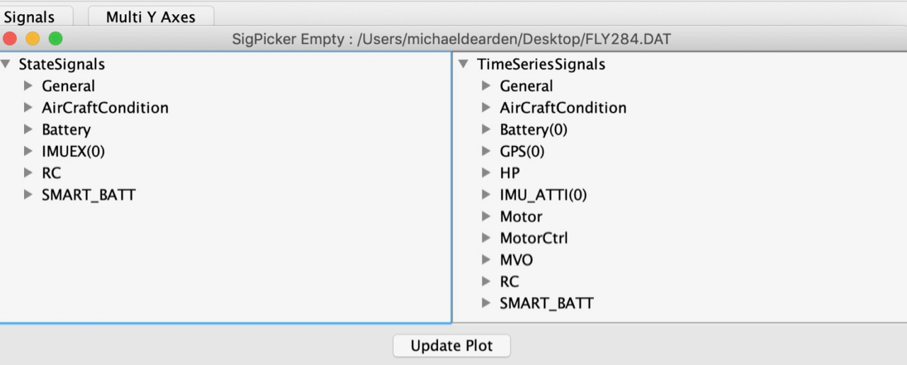

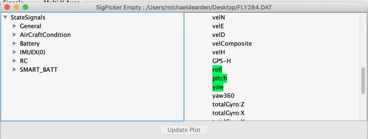

In the CSvView, where does one find the Roll, Pitch & Yaw parameters? I've opened all the options on the R/H column and none come up with them? Everything else is there so are they in a different file??
Answered my own question, I was running an older version of the program. Now found latest 3.3.6 and there they are :p

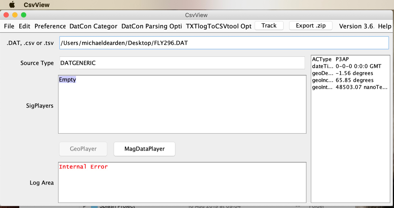

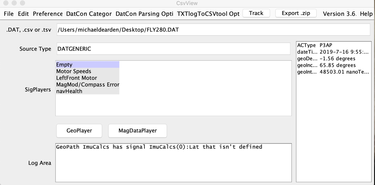

Um, for some reason it isn't available since I went up the the lates version of View and I get an "Internal Error" message??

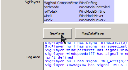

This what it should look like with SigPlayers and Log Area occupied.
I sent a report to [email protected] and they came back asking the same thing but I can't find the "CsvViewLog" anywhere in the folder?
However I seem to have resolved the problem.
I initially unzipped the downloaded file in the Download folder and then copied the CsvView 6.6.6.jar into another folder where I wanted to run it. I guess there were files in the Download folder that it needed to run.

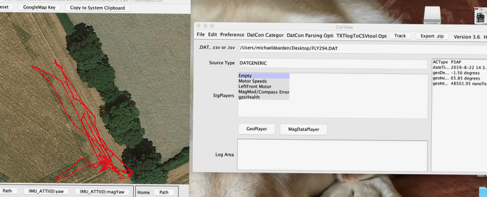

I have now unzipped the downloaded file in the folder I wish to run it from and it works just fine!
I must now learn what all thew different things do!
