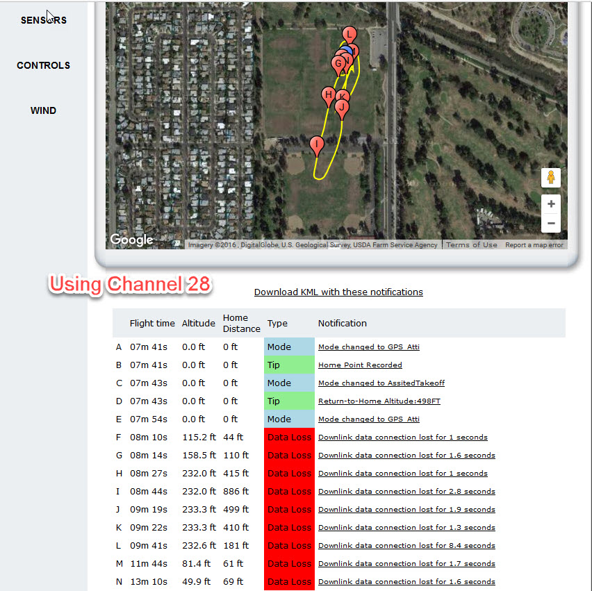

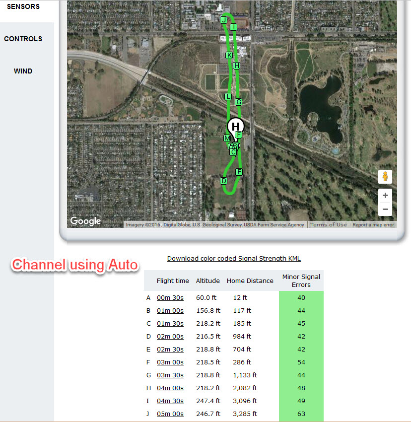

I finally had time to get out and test my channels theory. Previously I had been flying using the channel hack that provided more channels. It made sense to me that those additional channels had less traffic which would afford me a better signal. But, not realizing it, I was getting really bad signals using those additional channels. I kept changing through the various additional channels and all of them were about the same... BAD. Through this process, I had purchased a new Antenna (unboosted) from FVPLR and when that didn't work any better, boosted the same antenna. It helped but only a very little bit. I was not happy.
Then one day, I said to myself, self, try the AUTO channels. I did and have been flying happily since and at much greater distances and without lag and without warnings.
Attached are two photo's (if I can get them attached correctly) that show me using channel 28, and the other using Auto.
I'm not sure how the rest of you are doing with the additional channels, but this is my proof and I am happy. Happy flying with auto channels or even selecting a specific 1 through 20 channels.
P.S. This is all done on the same day flying two different flights but using the same battery.
