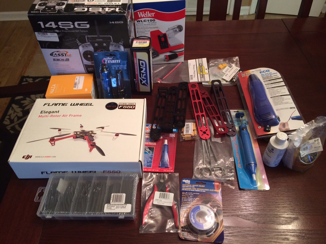

Here's my project for the day. F550 with Aimdroix arms, Futaba 14SG, Onyx 6,400 mAh 3S battery and $300 worth of misc tools and accessories (soldering iron, heat gun, shrink wrap, etc). First step this morning, Soldering 101 school on YouTube. Wish me luck!

With soldering as with any skill, practice makes perfect. Try sticking some wires together and practice making them neat - then cover them with shrink tube and shrink it. Be sure the solder flows - a blob of solder is usually bad - a cloudy solder joint can be bad - ideally it looks a little silverish and flows into the work. First mistake of beginners is a cold solder joint. Second mistake is overheating everything and getting wrinkled wire insulation and/or circuit board/component damage. Third mistake is using too much solder - it should cover the objects with no cracks or fissues but it should NOT be dripping down in clumps. A good set of 'helping hands' helps. I bought the one from Harbor Freight and put it on a much heavier base (almost all the cheaper ones are too light and skid around). I already did a lot of soldering and have a nice workstation solder vice but wanted the mobility of the cheaper 'helping hands' for working with the quads. Seems to work fine. A solder sucker helps for when you get something soldered and want to take it apart (or you put too much solder on).

I think I've watched just about every F550 build video there is plus half a dozen "how to" soldering videos. I think I'm ready for the challenge!

I made it up to the same point in my build today. The only difference is that my soldering job is uglier ;-)
Nobody warned me that flux turns to epoxy glue after heated, or at least that's what it looks like smeared all over my frame!

Try alcohol to clean it up.
