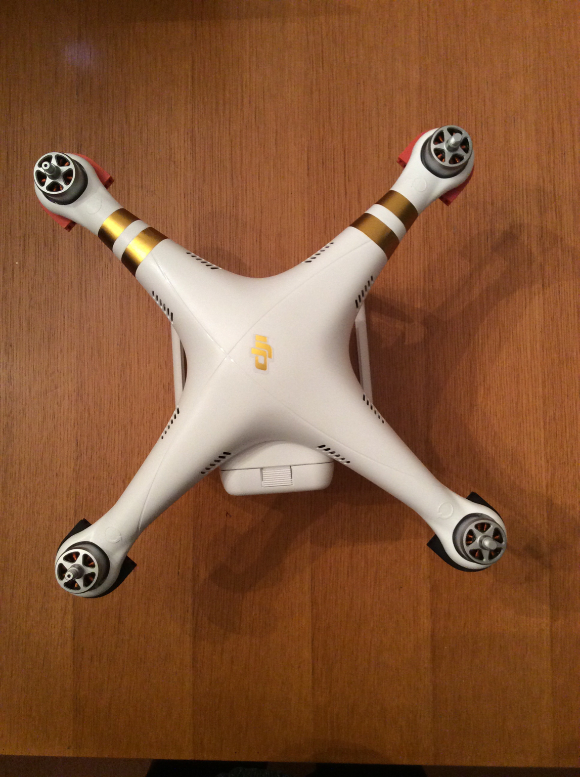

I had a repair on my P3P board and upgraded it to v2. The company which repaired it (not DJI) installed 4 new motors, 2 CW and 2 CCW.
However, instead of using the usual diagonal configuration, they assembled them in parallel, the two CW (with black propellers) on the left side and two CCW on the right. See photo. Is this normal? Is it a mistake of the repair service? Thanks
Mistake. You need to have the CWs and CCWs opposite to each others in order for the drone to stabilize and fly.
Edit: are you sure those are CWs and CCWs on the same side? Not just to color bottom that mas mounted incorrectly? Did you try installing the propellers?
The repair company admitted their mistake, they said don’t fly it, send it back to us we repair it for free. Thanks folk
