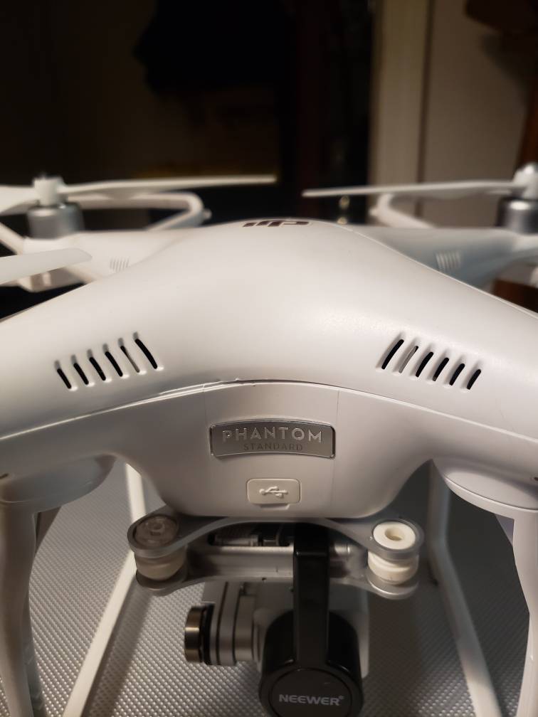

Getting ready to fly ,noticed this on shell is this not right how they mesh up?

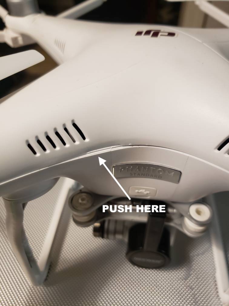

Yeh bit out there but looks like it should close with bit of help,,the shell been not quite clipped together properly,,if it to tight to spread that little bit just loosen shell screws and that will enable it to come together when that edge is on the inside where it meant to be,,looks like somebody treyed cause it has marked the plastic with indentation......
Push down on the top shell while pushing the bottom shell in, should snap back unless it's been stressed?
Reactions: mangycat
Yea, I think it just got pushed in. Stick a thin nail file or something in the gap to the right and carefully slide it left. It will probably pull that back out so it mates.
Reactions: mangycat
I agree with Ian. Loosen off those screws and it should allow you to push it back inplace. Leaving the shell with all the screws tensioned may permanently leave a mark, as would poking something in there to put it right.Take the tension off first. Good luck.
