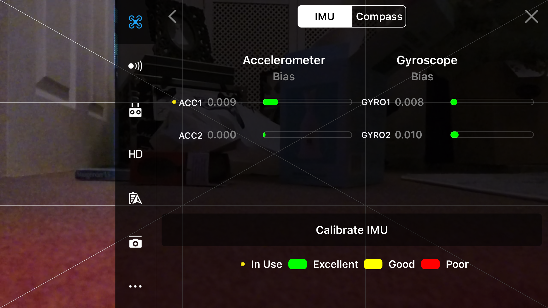

This was my values on my living room carpet floor
Those values seem a bit high compared to my post calibration numbers .002 or .003. Also, when Accelerometer 1 and 2 have great difference in value from one another, it often tells me a calibration is needed. Screen shot your current settings then perform IMU and compass calibrations. Be sure the aircraft is on VERY level surface for the best possible IMU calibration, it makes a huge difference !!!! I execute IMU and compass calibration if I find hovering issues or tracking issues after launch. I do this more often than I expected to with the P4 but it is well worth the few minutes of time. There's many factors that can screw with the compass and IMU, so always check this preflight. You'll soon recognize which values are good enough for stable and true flight (Lower values are good).
