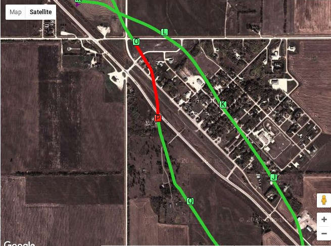

    Could be local interference. I went on an 8000 foot flight last week. On the way home, the signal got very weak. (See the red line in the attached image). If you look to the left of the red line, there's a combo service station/convenience store/restaurant located there. I'm guessing they were transmitting something that interfered with my controller. You can see the red only occurs when I was flying close to the station. You might have come across the same situation when you got near your target.....
