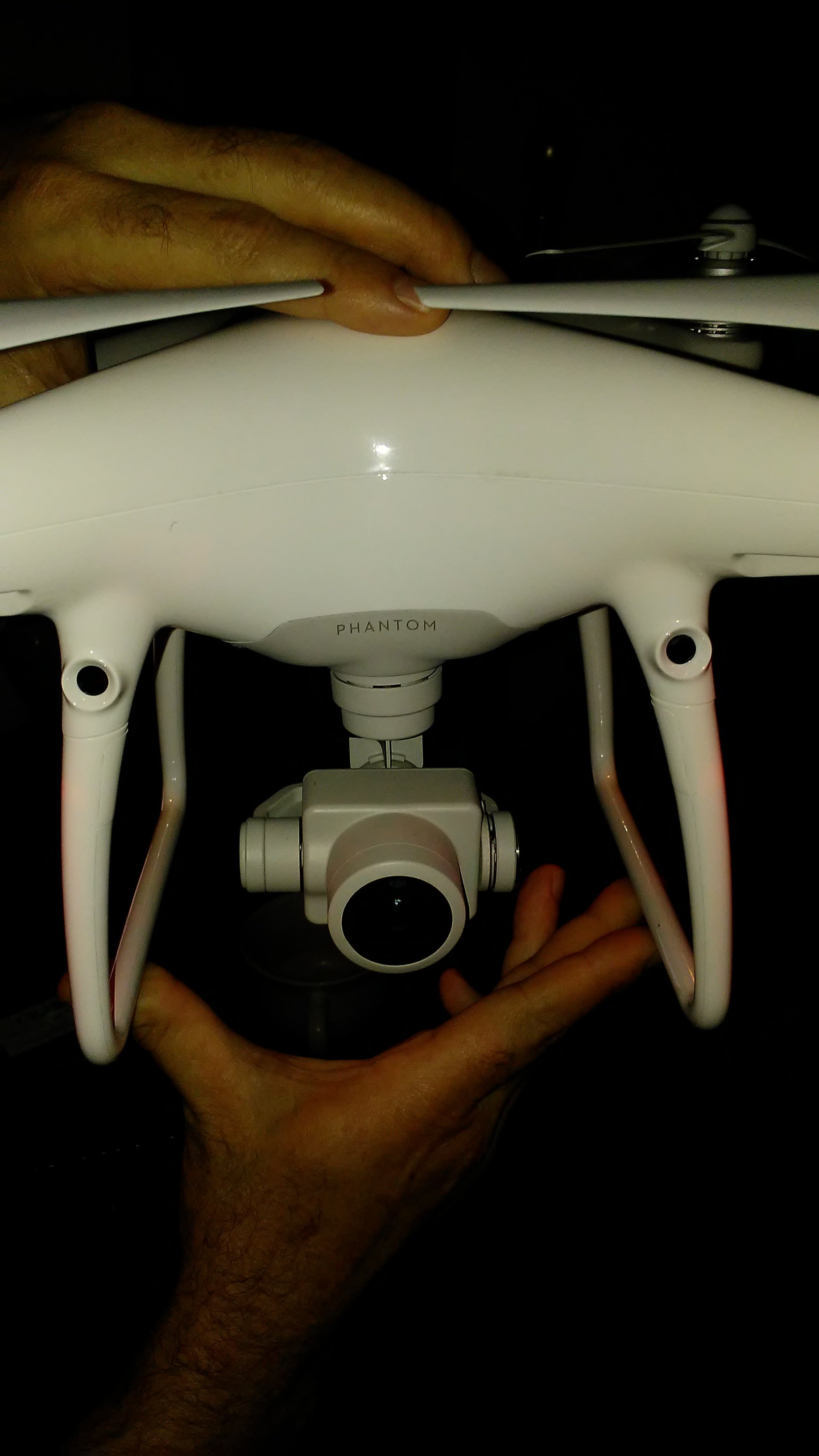

From the looks of this photo it looks like the legs were beat to hell. Full of scuff marks and scratches not to mention the little chunk of plastic missing. Doesn't look like "stress" cracks to me.
I've often wondered this. With the amount of crashing people do, I'm very suspect of "stress cracks" unless that stress is from repeated crashing or hard landings.

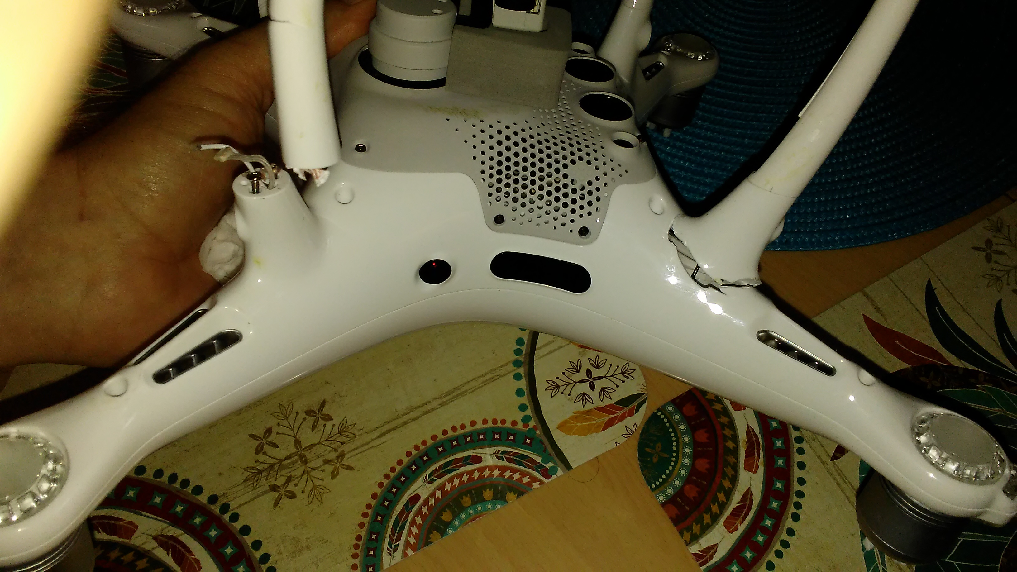

Was going to send in for repair(hit tree), but watch 2 videos on P4 and P4P teardowns on youtube, restarted after crash to check what was damaged, everything good except L. #1 compass, ordered middle shell, landing gear, repaired in 8days (mainly wait for landing gear), flys perfect, but compass #1 still disconnected, so I've ordered P4P power interface module ($18), thats where both compass ribbon cables from L/R front legs plug into, figure thats where hit was, but it still flies perfect, steady, long distance with one compass, just didnt want to chance getting refurb, cause my drone was excellent, just flew S mode while talking to onlooker. Total cost $100 + few hrs to fix, also get phillips #0, alan 1.5/2.0mm is all your need to take apart P4P. Videos are detailed but P4P video doesnt show 2 compass connectors to Power interface module have to be disconnected(press sides and pull) before removing middle shell from top shell, main stuff attached to top shell. Sodering even looks simple enuf if you need to replace top shell, or remove L/R ESC modules or Power interface module replacement. Its easy enuf and your informed totally bout your drone, each part can be ordered and replace, I can build a complete P4P, once you see videos you'll agree. Only four parts to shell, legs,Camera(grey part),middle and upper shell. All the modules are attached to the magnesium battery compartment in center, including 4 sensor cameras(F.and back).

View attachment 82884 View attachment 82885
Can you share that YT link, I have hair line cracks on my landing legs. No way I can send it back because I have jobs lined up, and DJI could take a bit before I get it back...thx
here they are, use tweezers, separating middle from top is 5 taps can be sticky, dont lose skrews,gimbal screws (8) can strip easy so use pressure when unskrewing, follow video exactly, the P4 is the best video everything the same as p4p except few minor details such as compass connectors, even shows how to remove top and battery compartment that all the modules attach to, steady hands and patience and attention to detail. Phillips #0, hex 1.5mm,2.0mm, tweezers,
