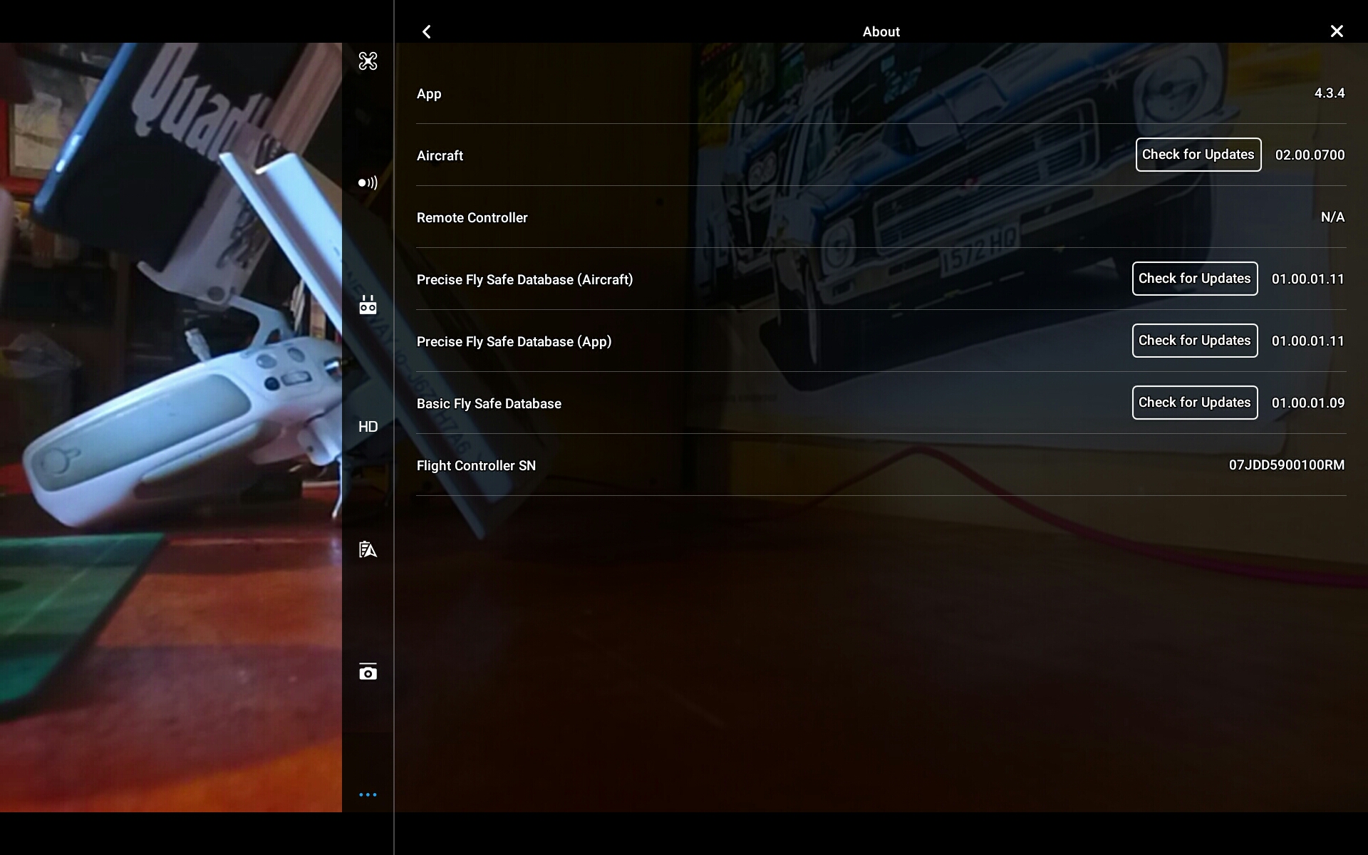

Are you able to conect to app long enough to Chek what firmware installed,,,here's picture of mine....it's in general settings under ABOUT down bottom of list,,,,software--don't you mean firmware ?,,it will show with drone off but cause drone off some might say check for updates...very unsure on what you downloaded (4.2.16 ) ???got a good sd card in,,,after you reinstall djigo4 it gives you latest version of app from playstore etc,Um, try relink aircraft to get good conection back,under rc settings in app.........but yes as post #6 mention check those ribbon cables........out of all this I forget to metion try another transmission channel under HD ,can auto it or custom your own channel
