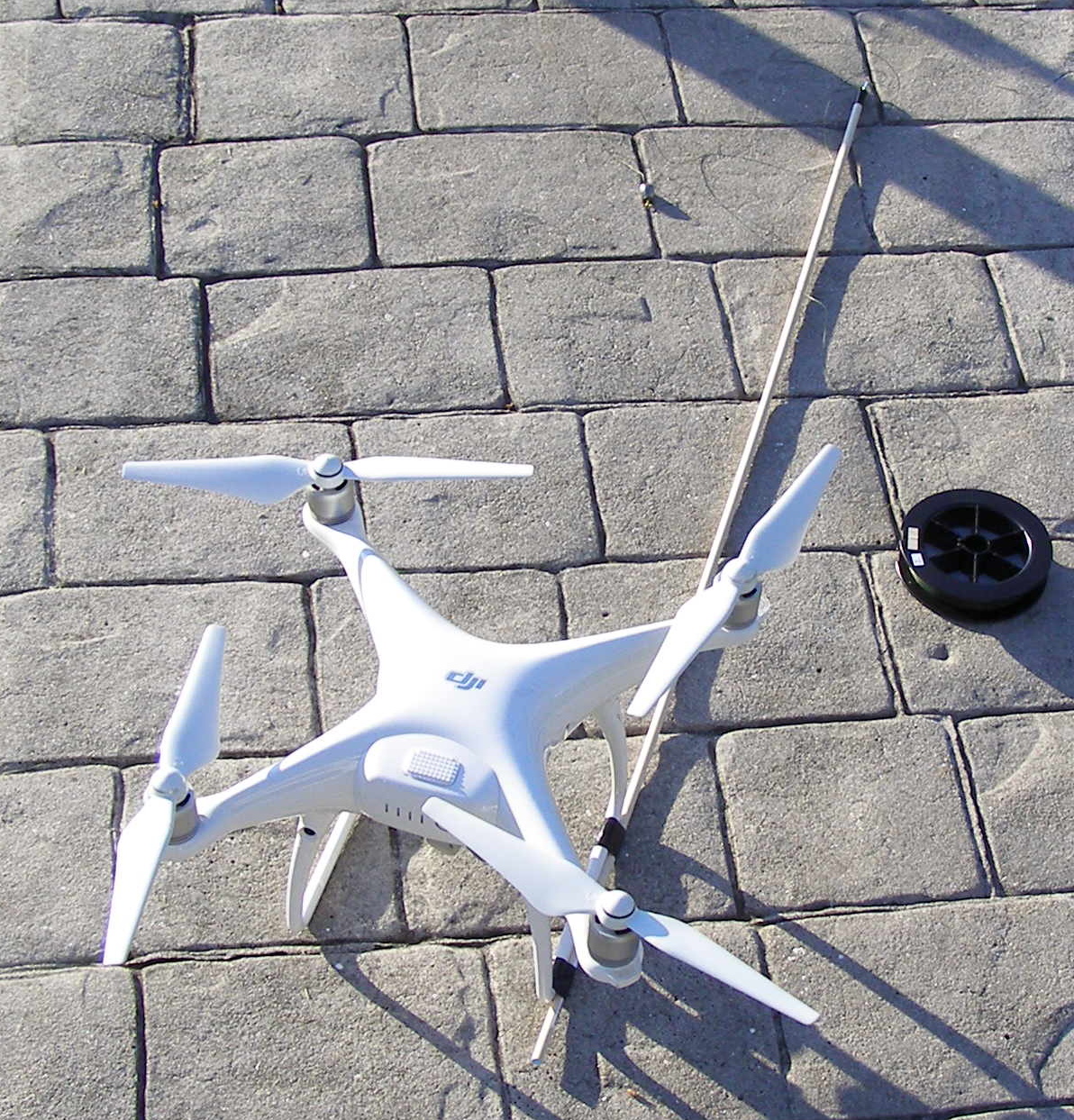

I experimented with using a P4 to get a line in place. For climbing trees, a bow and arrow rigged with a fishing line is often used. That approach is effective, but in some cases it's necessary to thread the needle with a near perfect shot. I once made such a shot that placed the arrow just over the desired fork. As shown in the attached photo, I used electrical tape to attached a light-weight wooden dowel to the P4. This keeps the line away from the props, especially after dropping the line over a target and then bringing the drone down. I wouldn't recommend this approach, which could result in a crash, but it can be done with care. You need to have a helper to hold the line just tight enough so that the weight is all the way up. Just for fun, I tried a flight with the weight hanging. The drone is actually able to adjust for the modification and fly level, but there is feedback if the weight starts swinging. As you raise it, the rate of swinging increases according to the physics of a pendulum, and the feedback increases. If the weight drops a little ways below the top, the line with the weight and the line coming down will get tangled. So you really need to keep it all the way up. Then maneuver the drone into the right position, and let the weight drop.

For your application, I don't believe there would be a need for the arm that extends off to the side. It is required for putting a line in place, however, because the drone must come down below the line after putting the line in place. The pendulum effect is more problematic when using an arm. I hope you don't catch a whopper that pulls your drone into the water!

As mentioned in the original post, one of the reasons is to rig a tree for climbing. As illustrated in this video, a bow and arrow is used to shoot a fishing line up over a branch that is hefty enough to be safe for climbing, a stronger line is pulled up with the fishing line, and finally the climbing rope is pulled into place. The same approach is useful for getting a line up in a tree for suspending Christmas lights. Yet another application is to get a line on a broken tree branch that is hung up high in a tree. Such branches can pose a danger if left in place. I found that a drone isn't useful for getting a line on a broken tree branch (it is difficult to get the line on the broken branch without getting it hung up on other branches) , but I think it would be useful for putting up lights and rigging trees for climbing.
