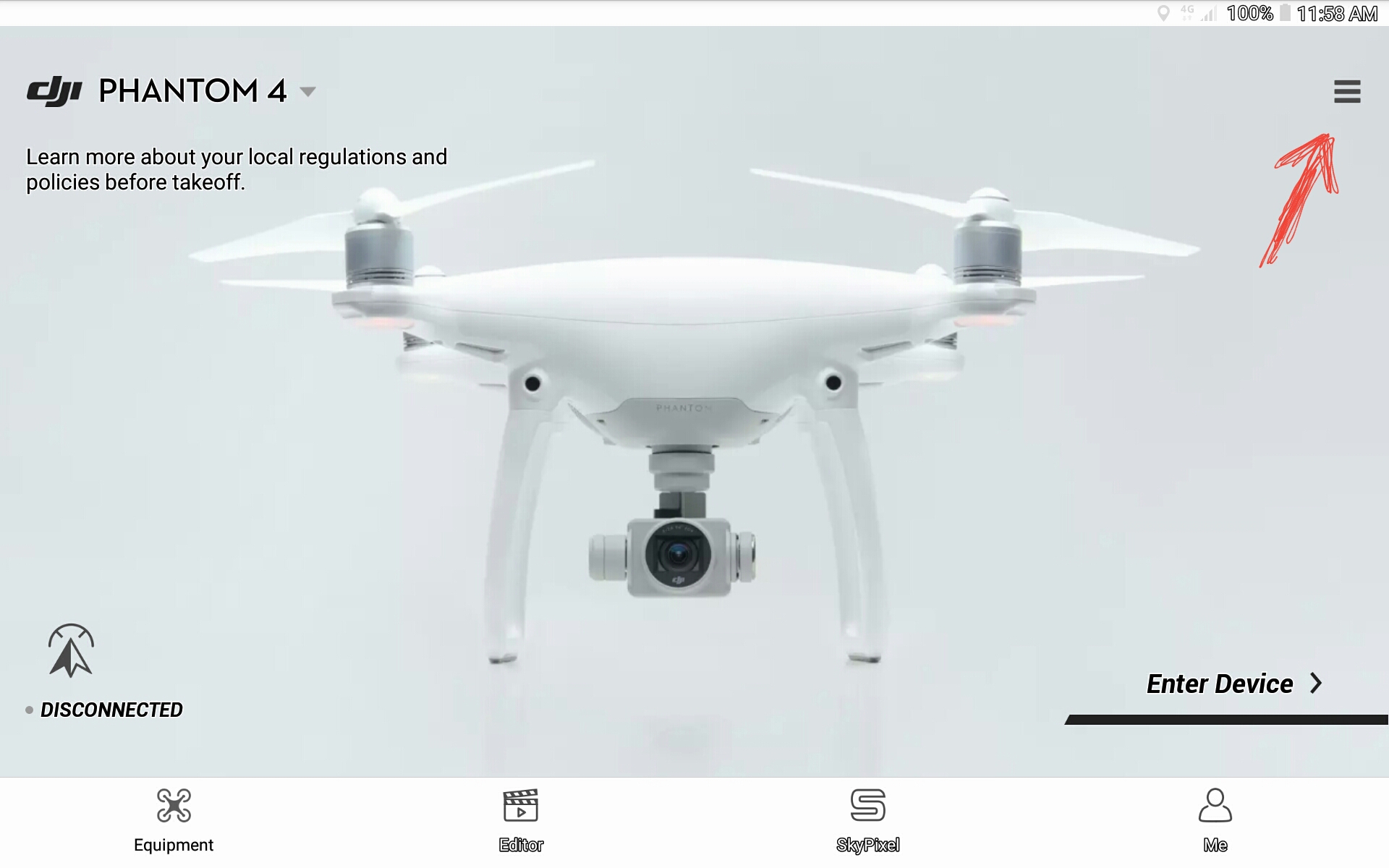

Get home page up and click those 3 lines at top,it will then bring up flight records if any

Only my flight records show up there, so I wasn't sure if records from a previously connected account would show up in my flight records.

Get home page up and click those 3 lines at top,it will then bring up flight records if anyView attachment 95084 ,unsure how to check if cam new but just looking inside batt compartment might show some sliding wear from batt going in or out,,,
That will only show flights done with that tablet or synched to your account - not previous flights done by someone else with a different tablet.
