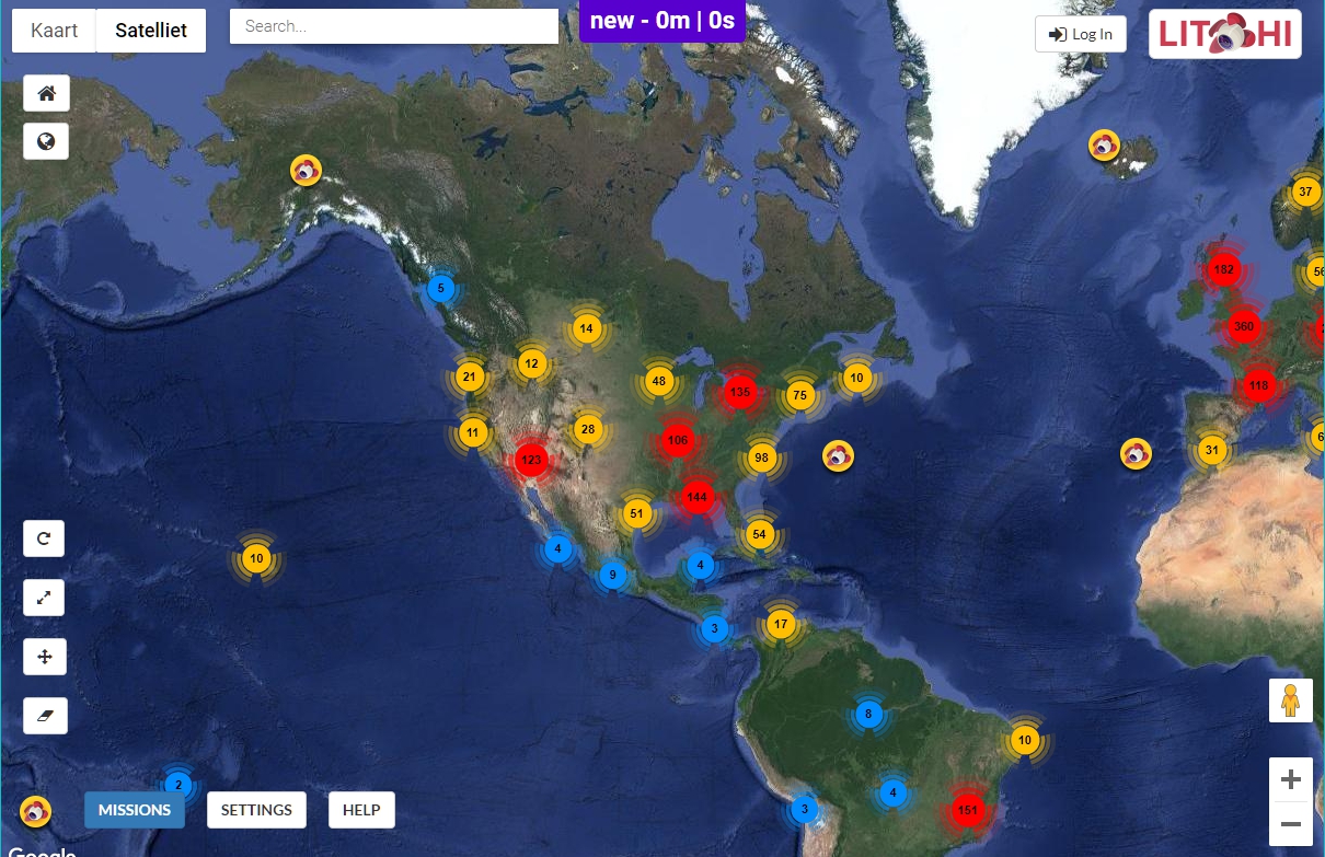

Mission Hub lets you plan waypoint missions from a desktop or laptop PC/Mac.
If you are logged in to your Litchi account (Hub Account), saving a mission will automatically synchronize it across all devices where you are also logged in.

I was able to test Litchi again for the first time in several years. So here are the steps I followed and it worked as planned:
Plan the mission on mission hub. Save the mission to the hub.
While you're still at home, open the app and be sure you're signed in. Tap the FPV button and take a look at the menu. The far right box is your login. If you don't see your name there, tap it and it will open a login screen. Once logged in, your mission(s) will synch to the device you're using.

When in the Litchi-Hub, Log-In with your litchi-account by klicking the "Log In" symbol/text in the right-top corner of the screen.
