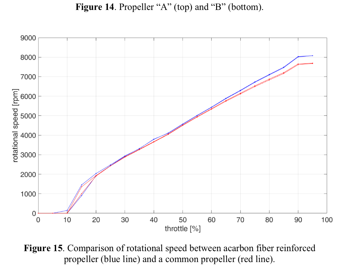

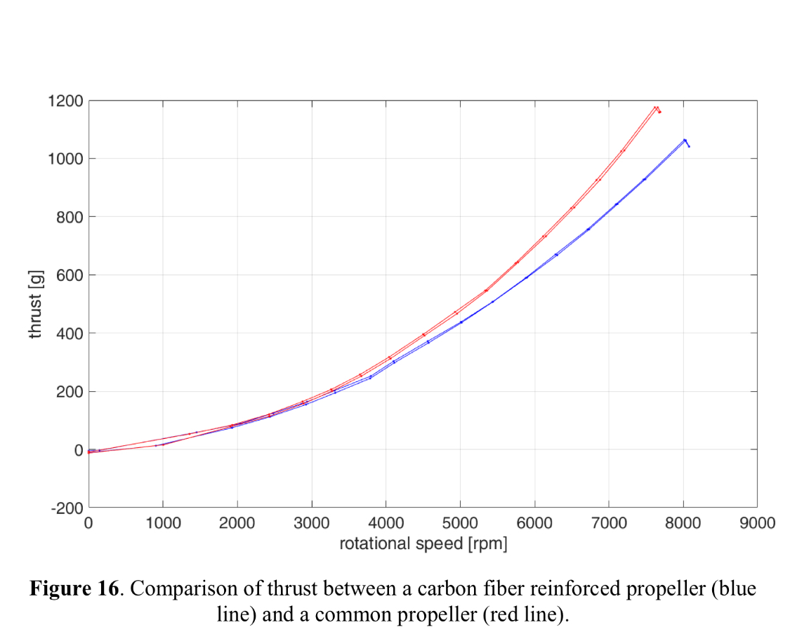

The following graphs depict the actual measured rotation speed and generated thrust between standard and CF props on a 920kv motor driven by a DJI ESC (you can read the full article here http://s2is.org/Issues/v10/n3/papers/paper8.pdf).
Standard props win performance wise, as to the best looking alternative- purely subjective.

There are many 9450 style so called CF props on amazon. None are pure CF. Better ones may in fact be a CF woven matt/resin construction- the genuine DJI are CF impregnated nylon. Telling us they are from amazon doesn’t aid clarity however it is arguably irrelevant for the purpose of this discussion.

You wont have any asymmetrical thrust issue if all props are producing similar thrust, regardless of speed. Any small variations will be addressed by the flight controller (to the extent any exist).
The lower speed depicted in the graph is likely simply a function of increased motor loading due to greater thrust being produced by the non CF props.
