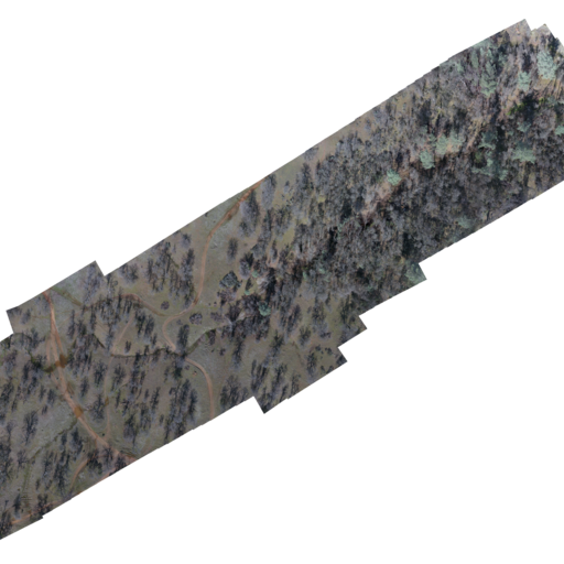

Ansia...what AGL do you fly at?? I really needed to see the ground as well as possible in this "map. I flew at 130 ' altitiude, and the bird flew it at approx. 6 mph. I increased overlap to about 85/80...and I think it looks terrible. I was so excited to get it back home and upload the photos....and then I got this later tonight. The resolution is terrible, and the distance seems very far off compared to the altitude.
Should I be making larger overlaps? Should I fly lower???? (It looks REALLY far away compared to the videos I take in Litchi, at greater altitudes!) Can I force it fly slower by changing the top speed setting? Should I work on manual camera settings???
Help from anyone would be appreciated....

Great Advice! Thank you. Mabe you can take a look at my prior post, with my first map over a creek area. I want to fly as closely as I can to get the best resolution. But some Digger Pines preclude me from going lower than about 115 ' AGL. Any help would be very much appreciated. Videos I have taken in Litchi look MUCH better than this at higher altitudes, and I am confused as to why.
Help from anyone would be appreciated....View attachment 108669

Ansia! Sweet offer. Thank you so very much. However, I AM a FOOL! I don't know why I did not figure this out immediately. But this was simply the download from DroneDeploy, a small JPG. The "real thing" was actually quite phenomenal! I saw the real image on Drone Deploy; plus I stiched my own in MS ICE. Both look terrific.
I am still going to watch the video. It seemed a little over-exposed, but I did fly in the high noon sun. Due to the February sun, the shadows were a bit difficult, as well. I would attach the file here, but it is obviously too large. But I was very happy with it, as were the clients.
But your cheerful willingness to help out is very much appreciated. I was stressed for a minute....
